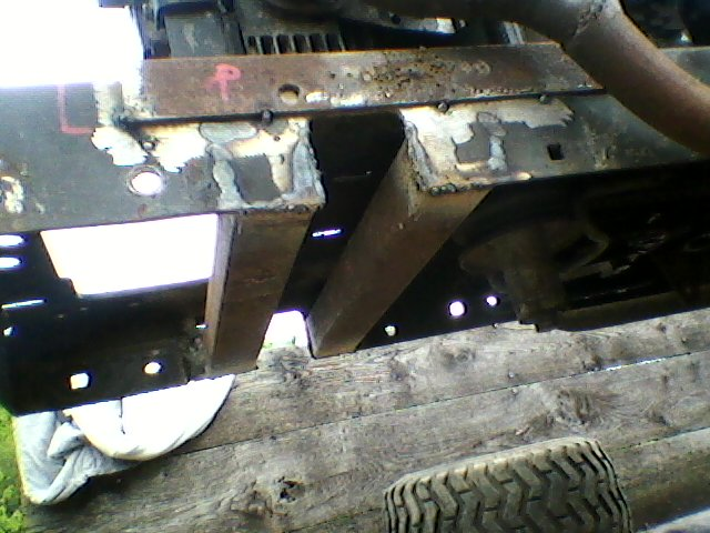

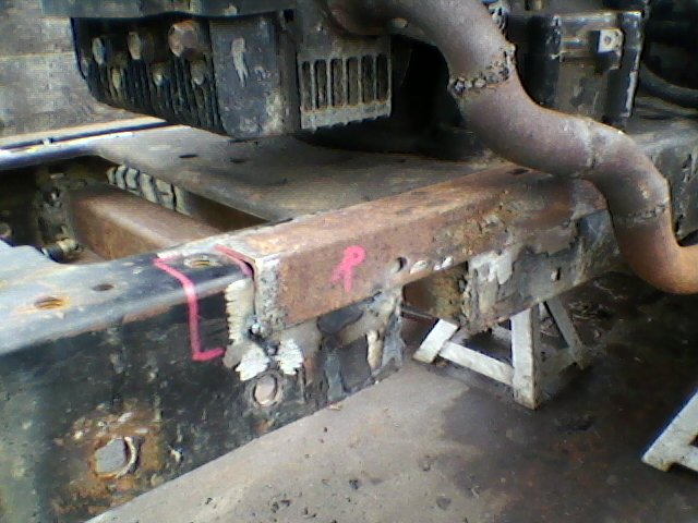

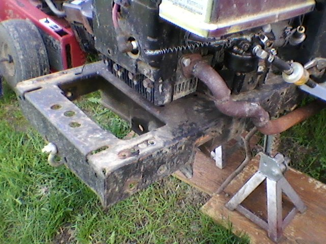

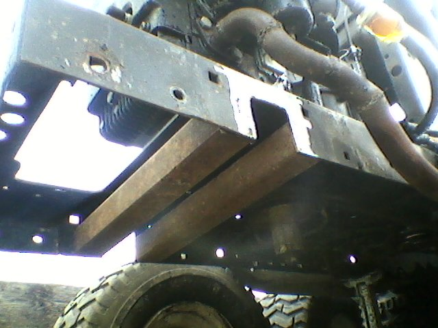

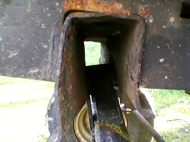

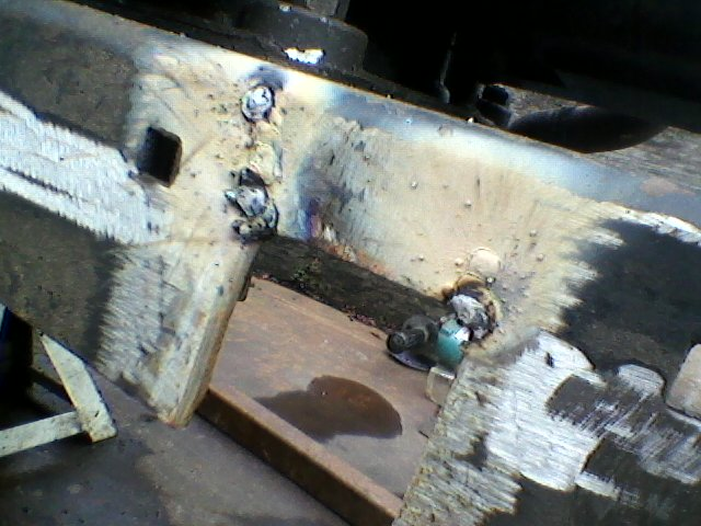

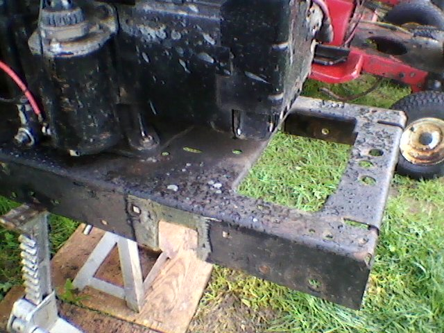

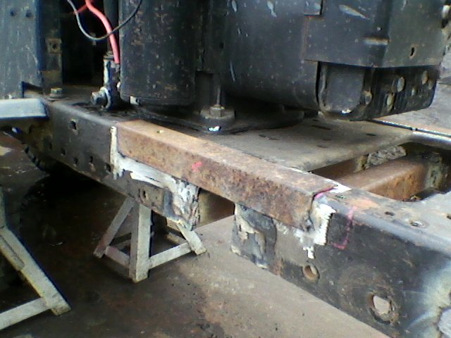

Well as in the video you can see my front end was F#@%ed i quickly built it and it was level with the stock front tires but i want to put bigger ones on the front so it will sit to high. Also it wasnt rigid and was weak as i didnt get around to putting support arms. But i've been messing with it some got the front hood/grill off the hood mounts off and front axle off. I cut the factory c-channel that the axle pivited in due to being bent and cracked. well i decided to use a axle off a diff tractor of mine im going to weld the seams solid and add grease fittings.
Heres some pics
As u can see its shot lol
stuff all off working on taking out the old c channel
got it cut out what a pain in the a$$
decided to use the old woods truck as a lift to work on the tractor works perfect lol redneck
welded up the stress cracks in the frame then grinded smooth afterwards
fitting square stock then welding in
adding frame strength need to pull starter&exhaust to finish fully welding it
should be alot more beefy then stock
all for today ill post more when i get around to it again

PostSubject: Re: Craftsman II Mudder Project   Wed Jun 06, 2012 9:22 am
Nice job on reinforcing the axle location. It's an area that gets beat up for sure.
