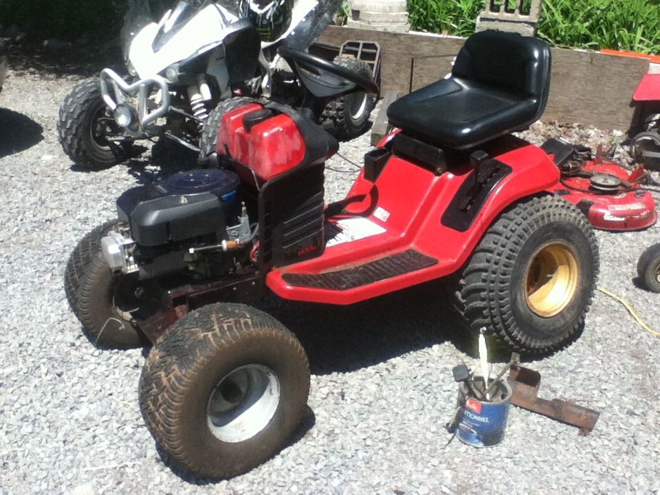

I recently bought a Toro WheelHorse for $30 from a friend. The next week I sold the Front tires off of it for $40 and the Deck for $50 so I made $60, I took the Hydrostatic Transaxle out of the Lawn Tractor and I have it posted online for $150(I am probably going to end up selling it for $100). So I will have $160 to play with on the Tractor so I went to BMI Karts and bought myself some stuff, an Axle, Bearings, Chains, hub, etc. I am going to buy a Rear Engine Rider Tractor from a friend for most likely $50-$100 and part the tractor out and take the Transmission. I have a Couple Pictures of the Fearless Fronts Spindle Extension Mod and the Back tires are Mocked up(They are Mud Blasters off of a 1986 Suzuki Quadrunner Parts Bike from a trade with a $20 Lawn Tractor).
It has a 14HP Briggs and Stratton OHV. The 2008 KFX 450 is my Brothers, Not mine:P

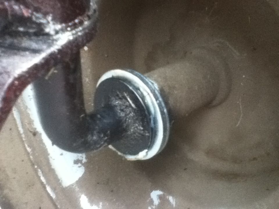

I needed to use Washers as Spacer to keep the Tire from rubbing against the Axle

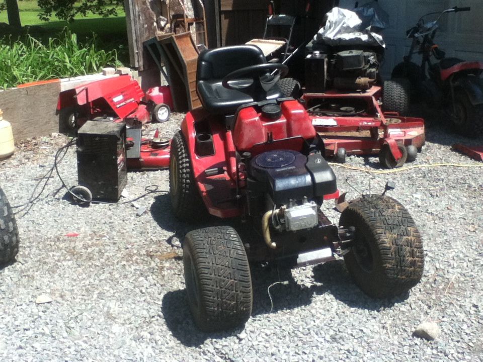

This is the Outside, I managed to put the Original Caps back on(thats why there is a washer is welded to another washer)
This is a Front View, My friend Cut the muffler off of it so I am most likely going to take the Quadrunner Exhaust and run it back or put the stock one back on.

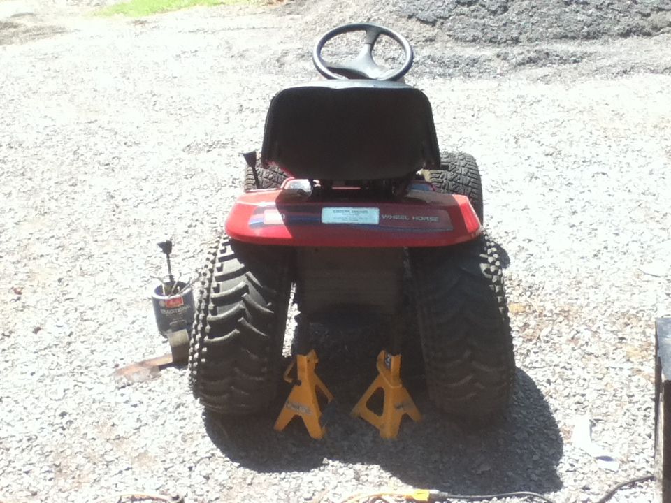

Just a back View
I will need a 7-8" Lift so I am going to need to buy some Square tubing from my boss tomorrow or something. I am currently already overbudget as is but I want it to look professional and preform well. I have spent $180 on parts so far and am going to spend another $50 on Brakes(I would prefer to have them, The push bar doesn't need that much abuse yet). I am expecting to have $300-$400 depending on how cheap I can get a Hood for it(my friend got one for $85 used and then spent $45 for the headlight, and a new one is $450 which im not buying).

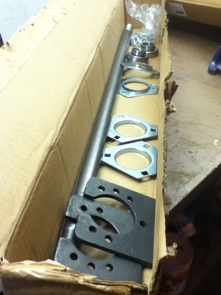

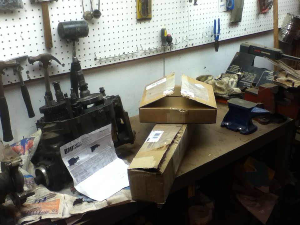

I Ordered My Parts from BMI Karts and I got the Shipment in Two peices, One on Wednesday(July 5th) and one Today(Friday, July 7th). I wasn't able to start on anything until I got the rest of my Parts Today but since Its Friday I have to hope my boss is going to open the shop tomorrow so I can buy some Steel.
Everything I bought came to a Total of $159.00 After Shipping(I also bought a Keyed Ignition for my other project, a Baja Mini Bike).

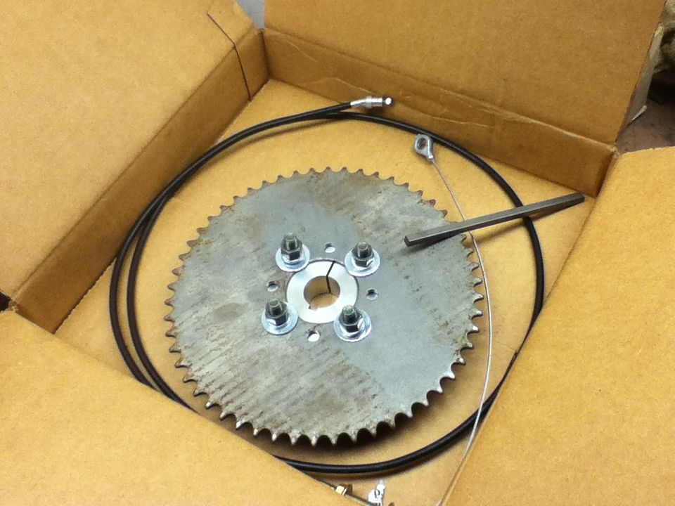

I got the Following:
This was the First Box, It contained the #41 54T Sprocket and Aluminum Hub, 6" piece of 1/4" Keystock, and my Brake/Throttle Cable.
This was the Second Box, It contained my 32" Long 1" Live Axle, and my 1" Bearing Kit.
I have a General Idea of what I will do for my Lift, The plan is to have it a Bolt on Lift so I can Make other Lifts according to Other Tires, Since I bought the 32" Live axle instead of a shorter length I am going to be making a higher Lift so the tires sit under the center of the Fender, Or else I will Tuck them in really far and put Duals on it(Most Likely Not because I don't have another set of tires).

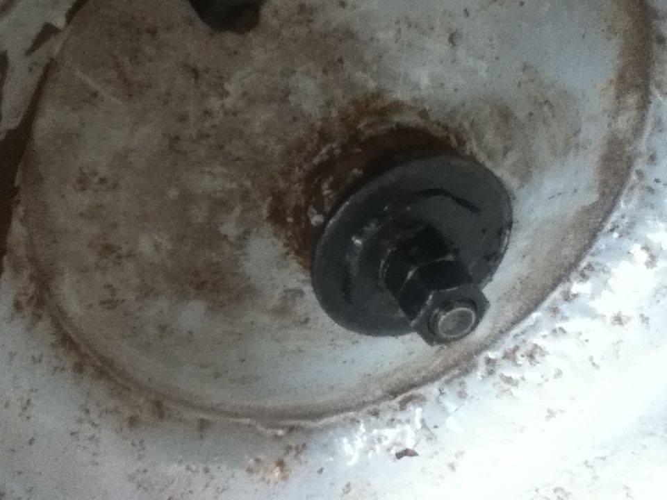

I just checked my Bolt pattern its a 4 bolt but they are 5 1/8"
This was the Best Picture I could get for the Measurement.

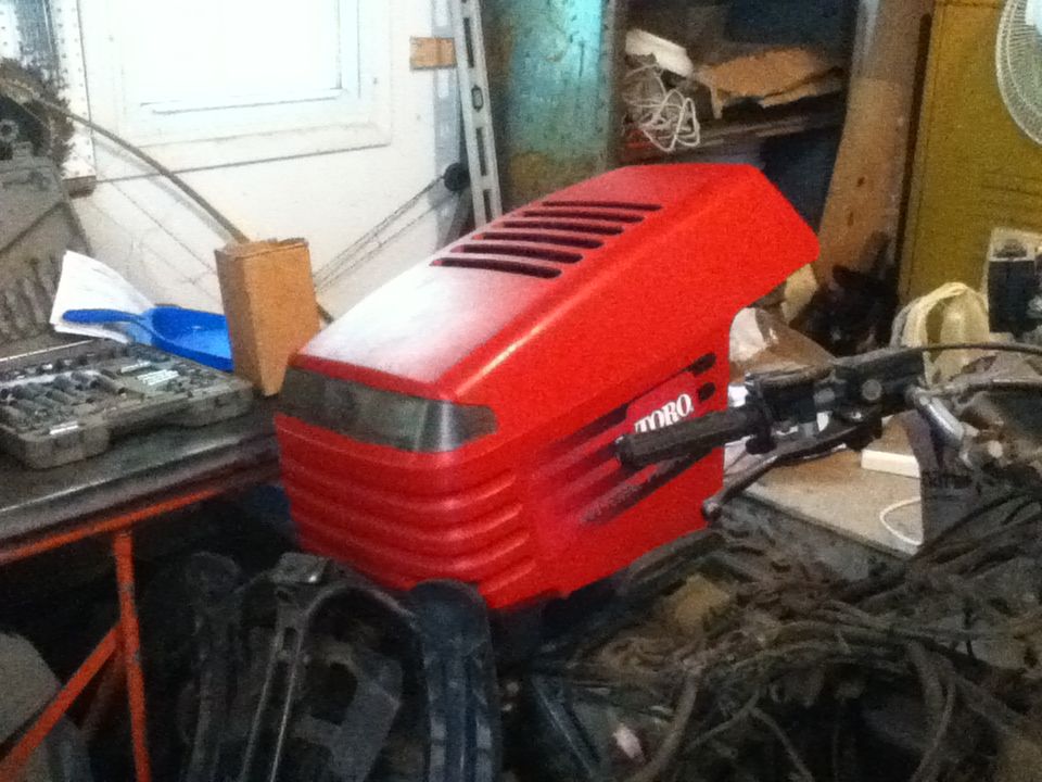

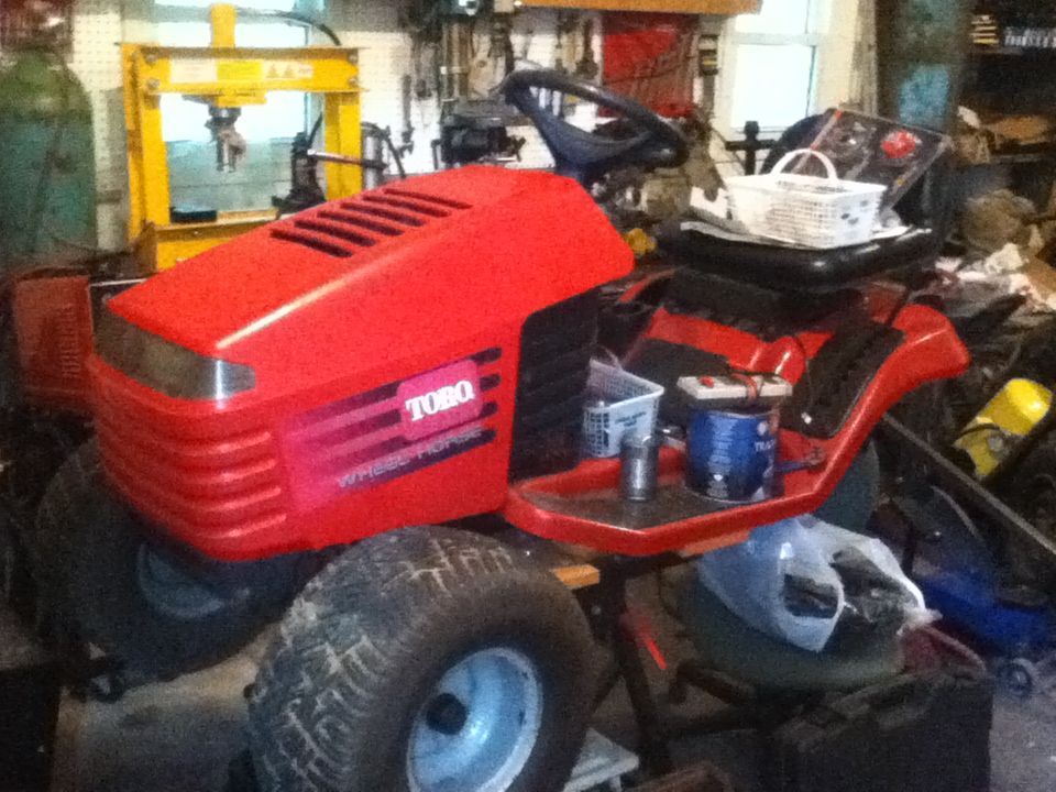

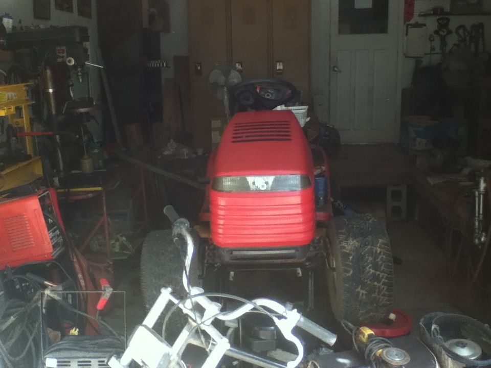

I picked up a hood from a guy for $100(Seems like alot but I couldn't find another Toro with a Good Hood and my friend who repairs lawn tractors and flips lawn tractors was interested in buying my deck(I sold it to him for $50) and he also needed a new Hood, he said he got the hood for $80 and had to buy a new headlight assembly for another $80, I had got my hood and headlight assembly for $100 so I feel that I got a deal considering there is no cracks or major damage(the most is the Stickers are peeling).
Here are some pictures of it.
This is the new hood.
Here is a general idea of what It will look like(without the rear end)
This is from the front, I am going to be making a push bar for the tractor so I don't break the Hood(Its only made of Plastic)
