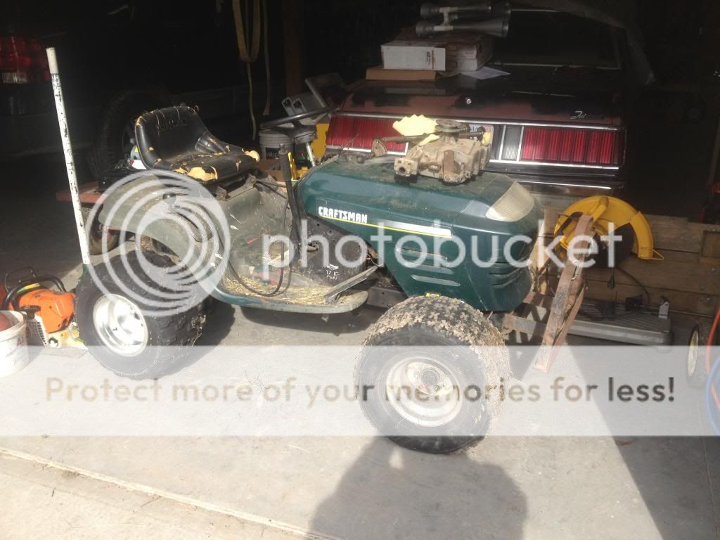

Oh, I could use it. It seals well, but would wobble awfully bad. Don't need it anyway. Got the other rims anyway. You may make out the warped rim in the pic.
TMJ's Craftsman LT1000 Conversion Thread - Page 13 IMG_2007_zps5fb64a43
TMJ's Craftsman LT1000 Conversion Thread - Page 13 IMG_2006_zps0000a8ea
TMJ's Craftsman LT1000 Conversion Thread - Page 13 IMG_2005_zpsdfe14b56
Also got a mint hood. Great shape for $20.

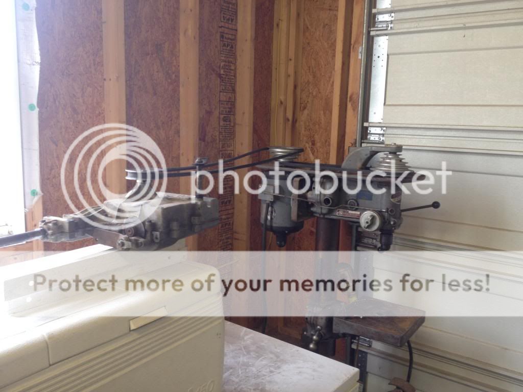

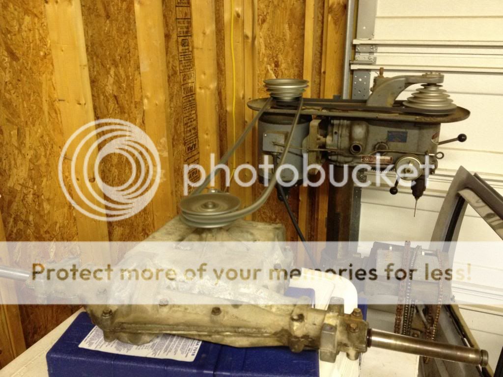

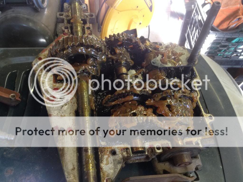

Got her back together and greasier than a greased pig! Had a hell of a time getting the axles to sit in the case right. Took several tries to get it to work. Don't know what I did to get it to work but I don't really care right now. It's together and I can actually turn the thing. Had a bright idea to test it under high RPM without getting the oppey running. Took the drive belt and linked the tranny ,sitting on a cooler, to the cone pulley of the drill press. Was able to test it in all gears to ensure it worked. All is good so far. PS, Butch is finally out of the hay shed!  Laughing

That could be the first 5-speed beer cooler I've ever seen...
TMJ's Craftsman LT1000 Conversion Thread - Page 13 Facebo12
Join date : 2012-04-23
Posts : 1051
Forum Rep : 10
Location : Galion, OH
TMJ's Craftsman LT1000 Conversion Thread - Page 13 Empty
PostSubject: Re: TMJ's Craftsman LT1000 Conversion Thread   TMJ's Craftsman LT1000 Conversion Thread - Page 13 Icon_minitimeFri Feb 07, 2014 9:52 pm
If this was facebook, I'd unlike this so I could like it again. Love unusual testing methods Very Happy

HAHA. Thanks. Twas a Fleeting idea that popped into my head. I'd say 1750 RPM, that's about half throttle on the Oppey.

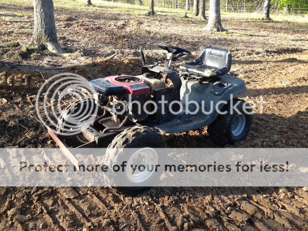

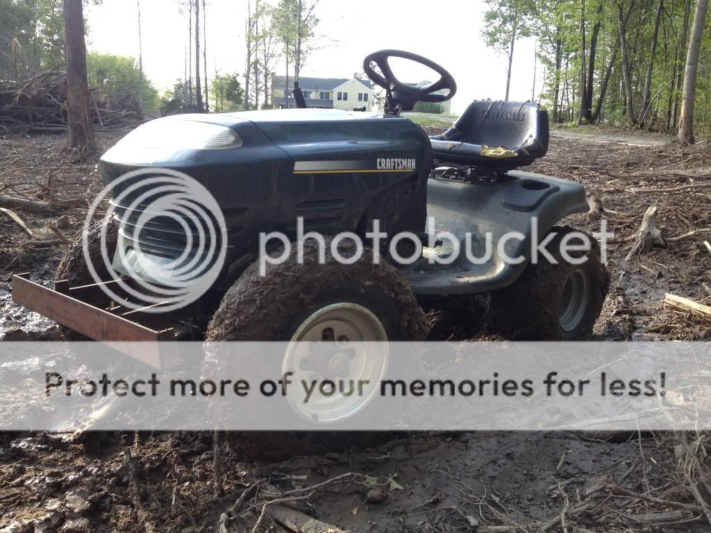

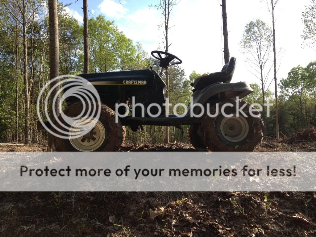

As always, no problem. It's what these build threads are here for. So, a much needed update WITH PICS!!!!!!!!! some reveiw first. Thanks to MowerDude, I was able to get a peerless 930 in the tractor to replace the spicer 4360 that I gave my bro for his pedal car build. That was about as far as butch got till, I broke down and bought some new ag tires with rims for the rear. After some mods to the Trans, which included shortening the extended shift shaft, I threw it in and went for a test run. Super nice trans(good reps for you MD). After the test, I took the trans off and apart to fix the shift ball wish had fallen out. This is where it got sticky....Literally. The stupid idiot I was, I took the top half of the case off, Right over top the bottom half. I ended up dumping dirt and sand all over everything. So...., back to the grind stone I went and soaked and brushed every gear and axle in solvent. After everything was clean, I ended up shoving 3 tubes of grease into the sucker. This involved taking the case apart several times. This is where that drill press trick came in super handy. I had to spin the trans several times to distribute the grease around. After bench testing it on the drill press, Back in the tractor it went and all was well,that is, till I noticed a rather annoying problem starring a hole in my face. The drive belt was shot! So, I got a new one(best decision I ever made) and now all is well. Whew!. I use it everyday now. Love how it's running. Put the ATV front wheels back on that I first had on when I modded it for the first time. Kicking around a few wheel choices around for the front. Butch does real well in the mud. Haven't gotten stuck yet. Enjoy the pics.
PS, as of today, I now have more repairs to do. Broken trans bracket and sheared off shift lever. LOL  Laughing

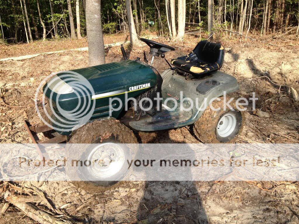

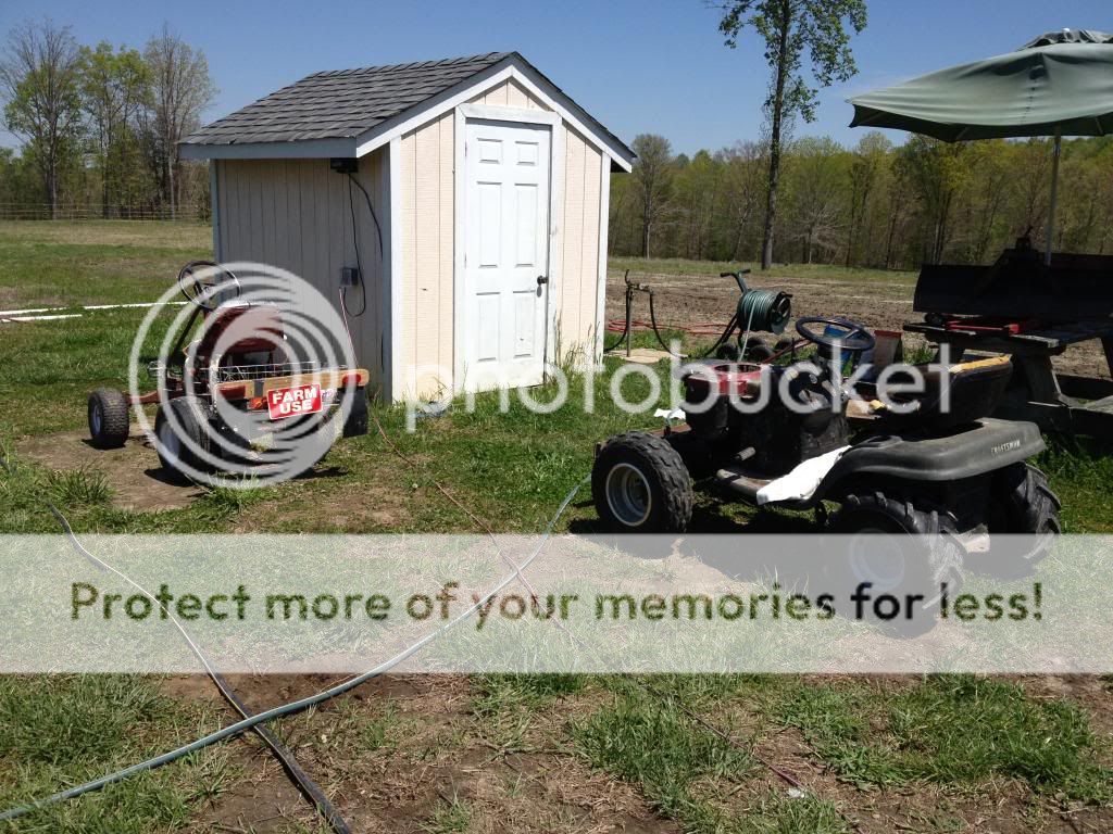

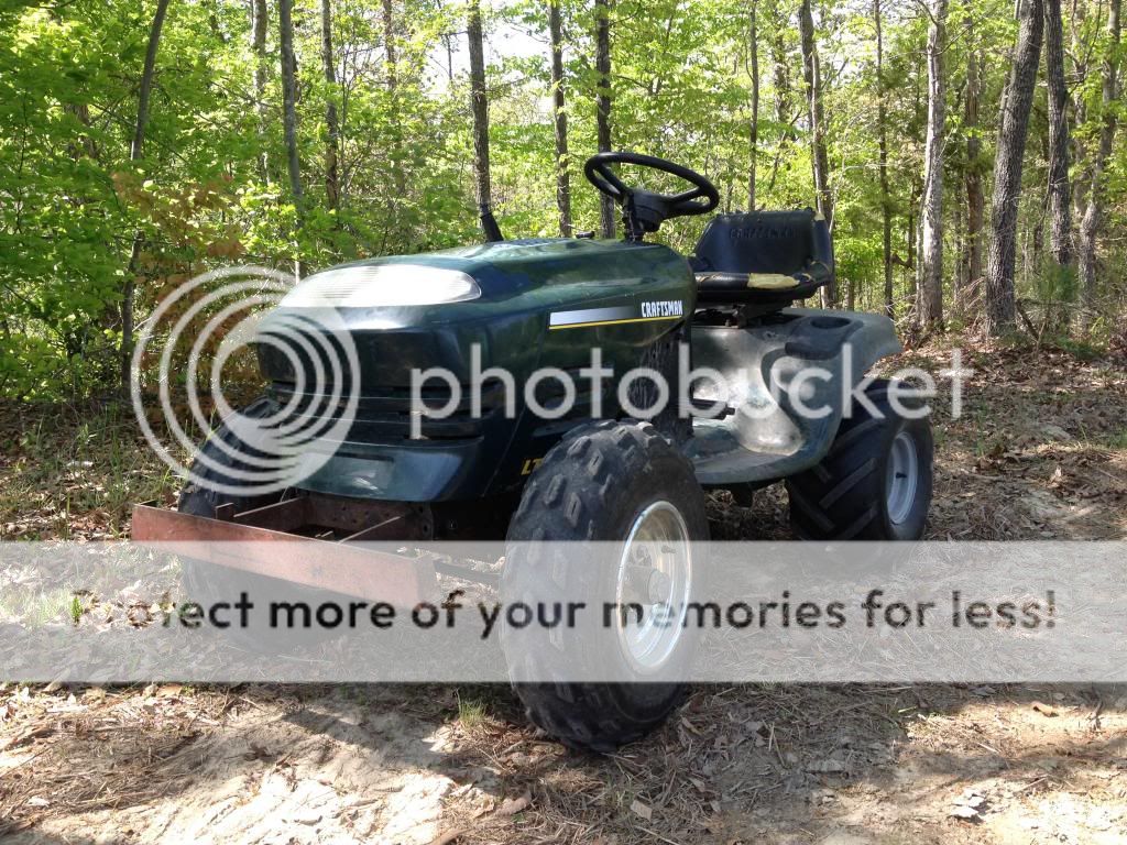

Shifter is fixed and back together. I also cut the hacked front bumper off. Will put a better one in later. Gotta make room for the Wheel horse Dozzer blade I bought. Stay tuned.  Smile  Pics are still stuck on my phone. Will try to get em on here soon.
Tractor Man Jeff
Tractor Man Jeff
Join date : 2012-06-26
Posts : 492
PostSubject: Re: TMJ's Craftsman LT1000 Conversion Thread   TMJ's Craftsman LT1000 Conversion Thread - Page 13 Icon_minitimeTue May 13, 2014 10:58 pm
Pictures as promised.
