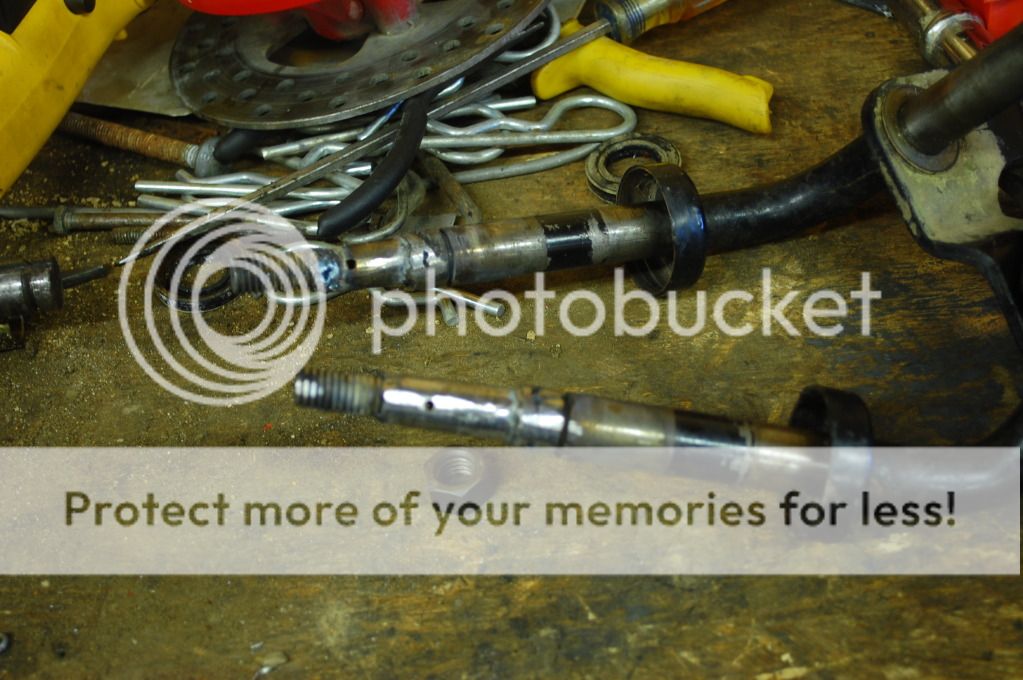

could you post a picture of how you have the spindals extended
Tractor Man Jeff
Tractor Man Jeff
Join date : 2012-06-26
Posts : 492
TMJ's Craftsman LT1000 Conversion Thread - Page 4 Empty
PostSubject: Re: TMJ's Craftsman LT1000 Conversion Thread   TMJ's Craftsman LT1000 Conversion Thread - Page 4 Icon_minitimeMon Oct 29, 2012 10:13 pm
Sure. Had to make em longer for the ATV hubs.
TMJ's Craftsman LT1000 Conversion Thread - Page 4 DSC_0632
greener179
greener179
Join date : 2012-05-31
Posts : 398
PostSubject: Re: TMJ's Craftsman LT1000 Conversion Thread   TMJ's Craftsman LT1000 Conversion Thread - Page 4 Icon_minitimeMon Oct 29, 2012 10:16 pm
thanks for the pictures i might have to copy that Very Happy
Tractor Man Jeff
Tractor Man Jeff
Posts : 492
PostSubject: Re: TMJ's Craftsman LT1000 Conversion Thread   TMJ's Craftsman LT1000 Conversion Thread - Page 4 Icon_minitimeMon Oct 29, 2012 10:19 pm
One thing I learned is to make a V cut on the axle that your welding on, kinda like a pencil tip. IF you don't, it wont get good penetration and will break, like mine did.

Instead of just butting the piece of metal flat against the end of the spindle, Make a pencil tip like cut on the end and then but it and weld. This allows more penetration. Hope that helps.
