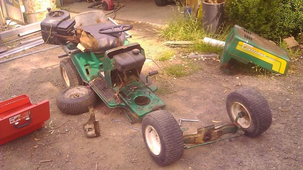

so this mower had a pulley swap not long after i got the mower, back was 2and a hafl inches and the front was 3inches i think, it went fast but had the motor screaming its head off, belt lasted 4months before making a flat spot so i put it back to stock pulley ratio which was 8in back to 3in front, too slow i think so ive changed acouple of things. my mower in bitsVVVVVV
fast mower update 2012-12-27163425_zps48dde12c

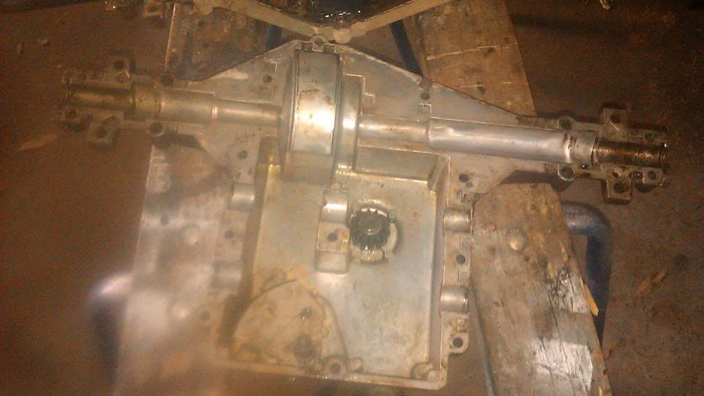

trans axle with the casing off

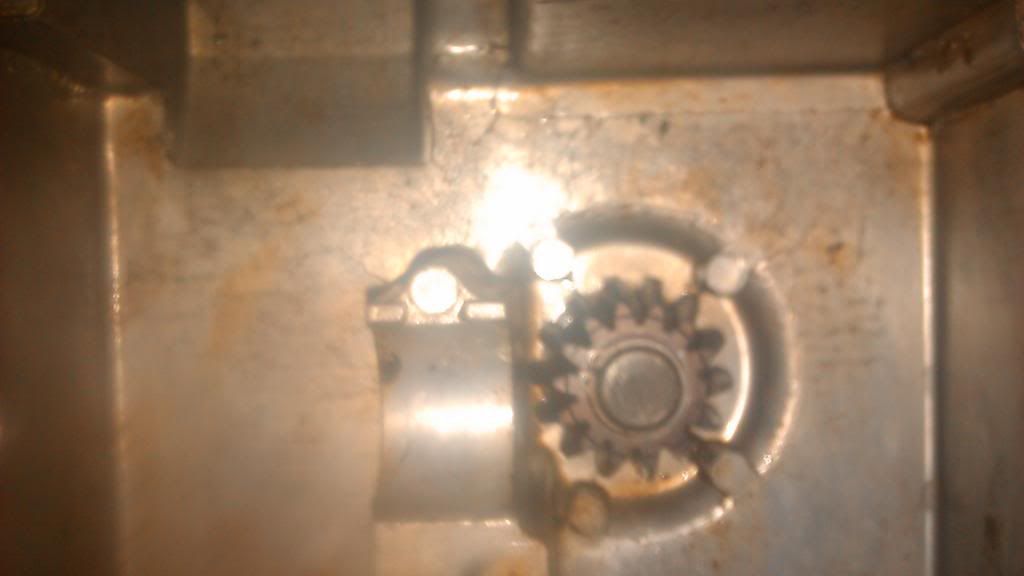

cleaned transaxle casings ready for new grease

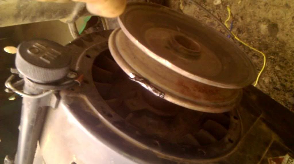

pulley centre swap, normally you would just buy new pulleys but i choose to stay cheap as possible.
fast mower update 2012-12-28135122_zpsd446cccd

front pulley all done was a back pulley.
fast mower update Bigpulley_zpsf1b76044

all welded up front on the pulley

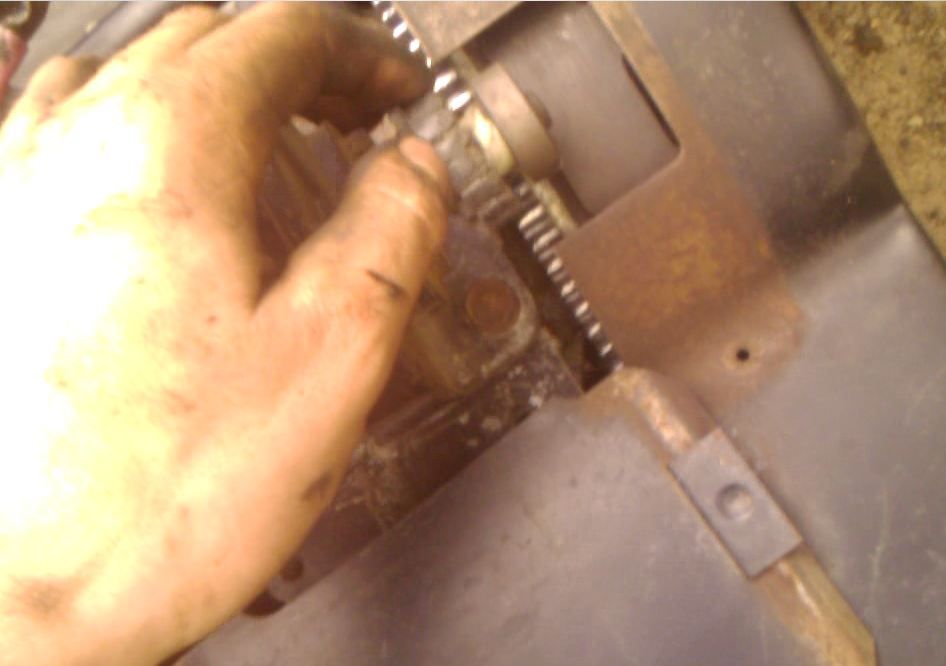

starter gear teeth are ruined :c not happy at all and did have to push the mower home when it stopped
fast mower update Chewedteeth_zps2ccdf0e7

Very nice work so far. That thing is going to fly with that big pulley. It might be a good idea to put all your pics in one post instead of making a single post for every picture.

With a large motor pulley, itll have some initial take off lag, but once it rev's up itll go pretty good.
My murray with an 18HP twin and 6" motor pulley took a few seconds to get going- but it brot the RPM's down instead of screaming the motor.

Id get plastic starter gears, they make metal ones but if it was used on an aluminum flywheel gear, itd literally strip the teeth off it - metal gears are only for steel flywheel gears.

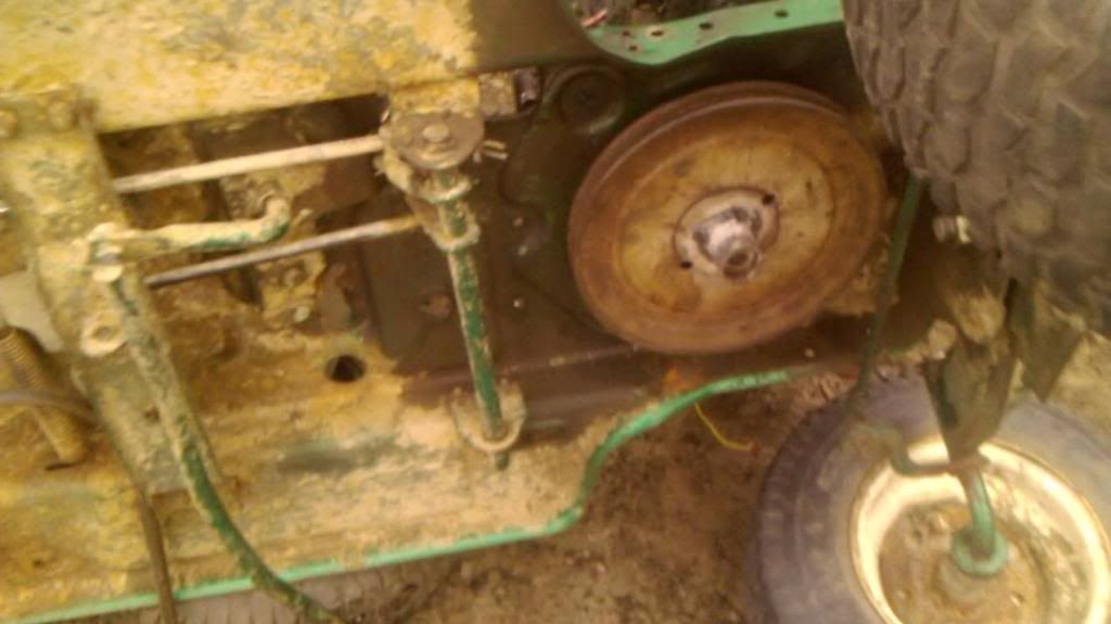

yer i hope i do to, im gonna buy a pack of two or three starter cogs and also try to get a pull start but here is some more pics of what i did today, had to also pull apart the transaxle again, wanted to feel abit safe by putting some gasket goo around the edges. btw my start gear on the flywheel is steel but i might just stick with plastic ones because i did get a long life out of my old one.
fast mower update 2013-01-02184655

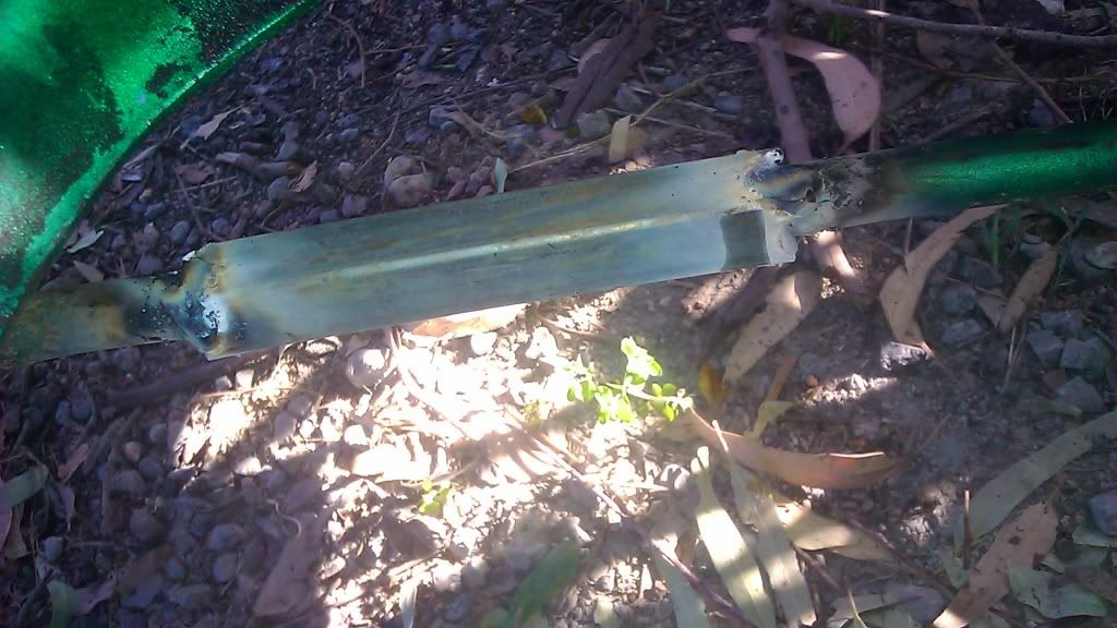

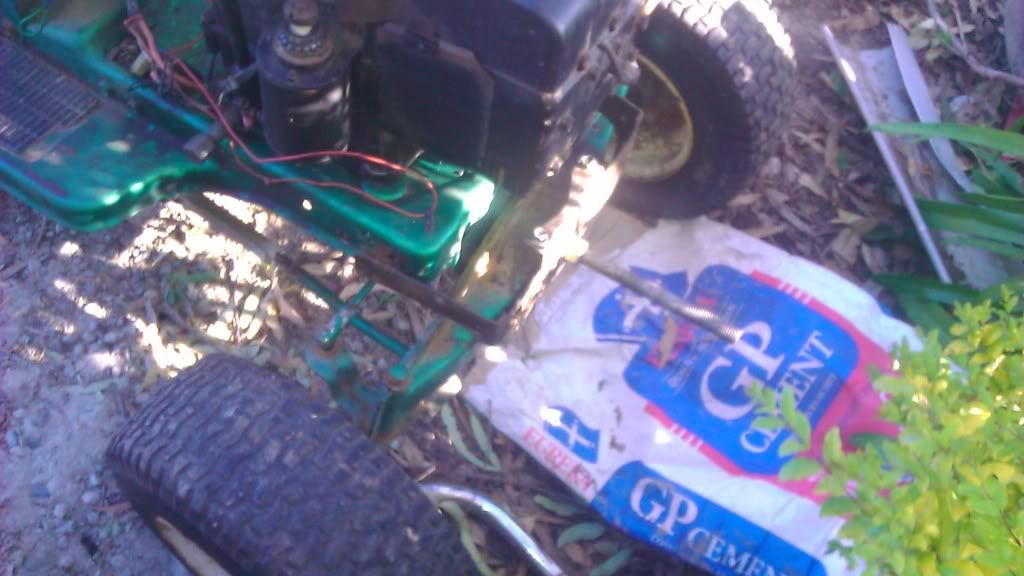

used some small box section to make the steering rod longer because i moved the whole front axle infront of the mower.
fast mower update 2013-01-02184636
reason for moving my axle forward, wasnt enough room for the axle to sit inbetween the front pulley and also the front pivot plate.
fast mower update 2013-01-02184708

Plastic gears will last a long time - have some tractors with factory gears and some ive changed more then once - which reminds me that i need to pick up a few extra gears....

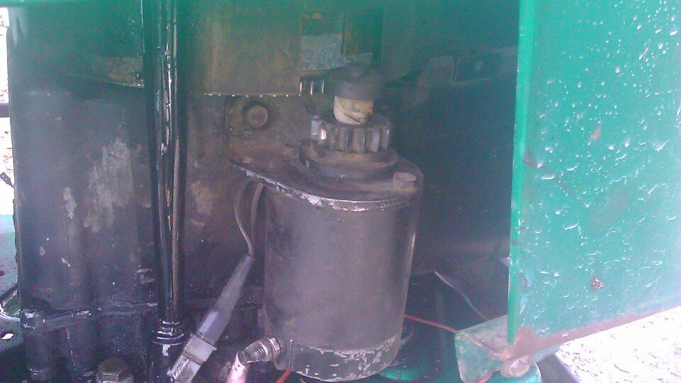

got some update photos as i did some work on it today to get it going! got another starter that has a better condition cog (freebie).
fast mower update 45486_586956751330936_346474_n
shes in and ready to start!

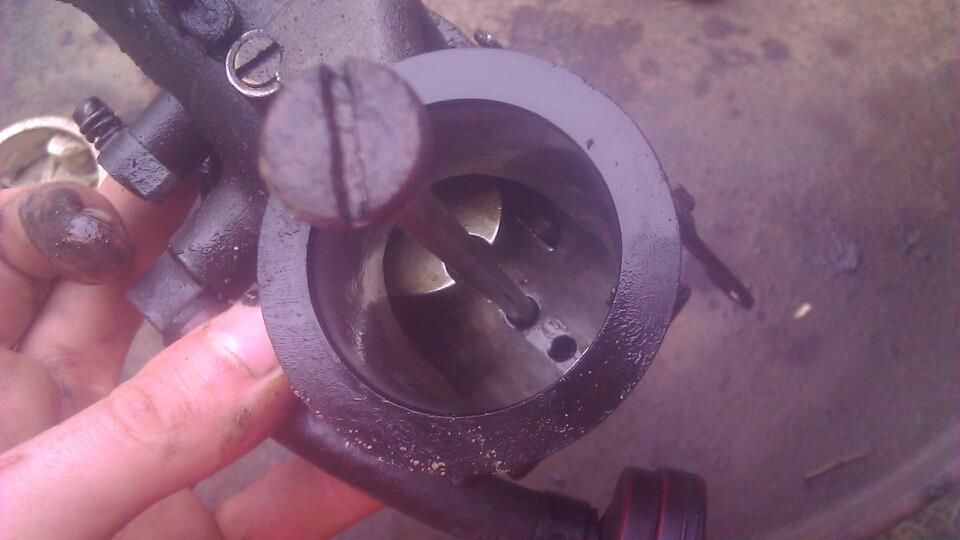

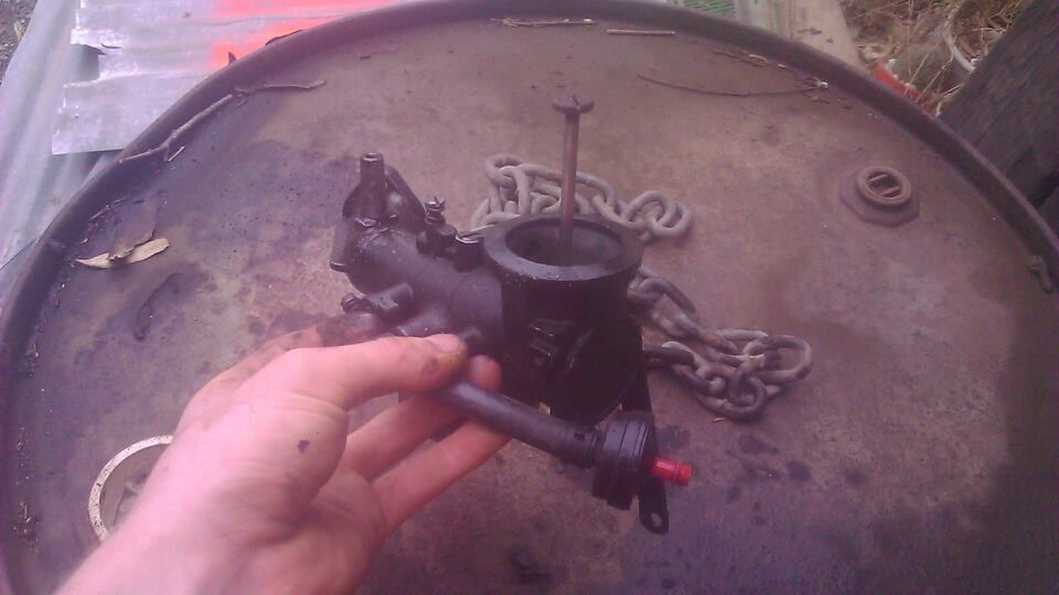

pulled the carbie off to clean it out, was lots of oil!
fast mower update 69674_586956884664256_905818727_n

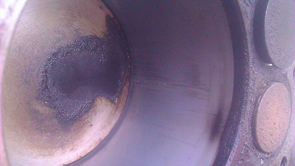

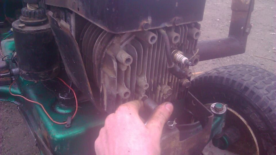

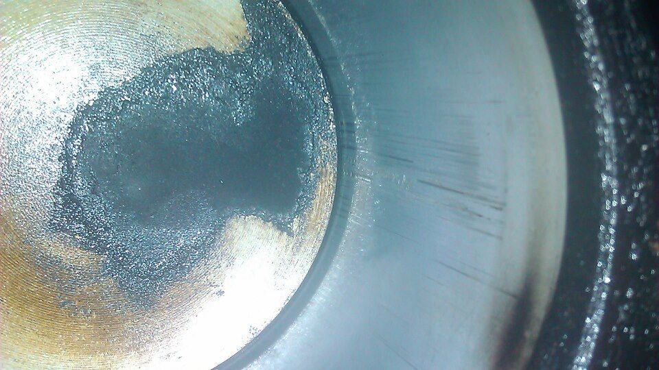

removing the head to drain the oil out and see whats the condition like inside.
fast mower update 23401_586957194664225_2140252337_n
wasnt too happy about this but i have found the oil problem with this motor (having to keep topping the oil up alot)
fast mower update 547040_586957374664207_2036194766_n
brighter pic with flash. its just that one spot but its basicully saying NO GOOD AT ALL.
fast mower update 582243_586957444664200_1307467904_n

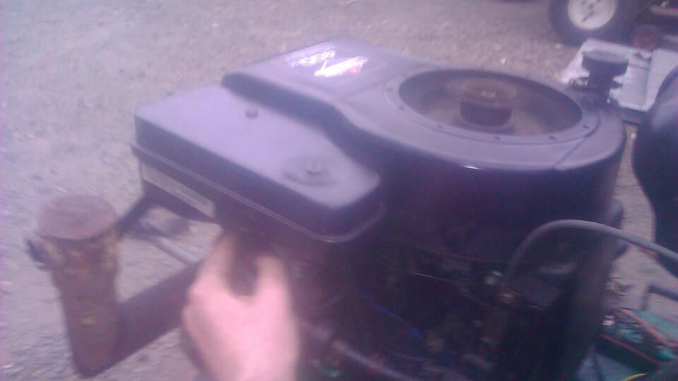

at the end of the day i managed to just get her going again, shes almost ready to go just need to work on brakes hahaha.
fast mower update 74108_586957821330829_1868107667_n
fast mower update Empty
PostSubject: Re: fast mower update   fast mower update Icon_minitimeFri Jan 18, 2013 5:46 pm
Make sure you put the sheetmetal motor cover back on or youll have over heating issues - the covers actually duct air down from the flywheel to cool it.
PostSubject: Re: fast mower update   fast mower update Icon_minitimeSat Jan 19, 2013 4:00 am
yer i had the cover on but i had to pull it off to get the the spark plug lead. i always use the cover.
