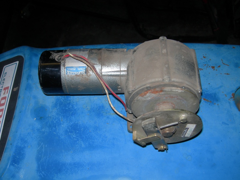

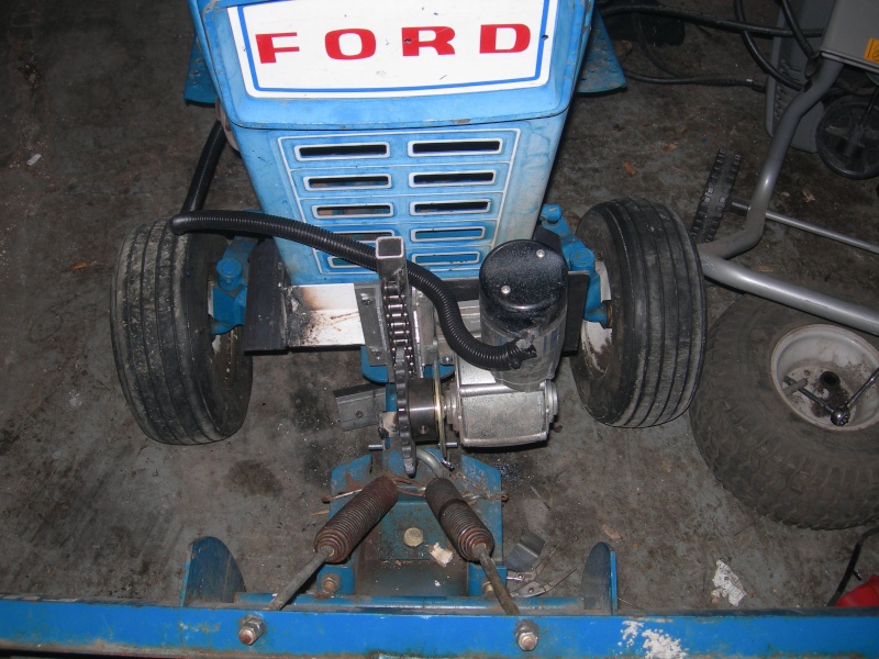

| Got the electric lift prototype built. This one has too much flex, i'll need to build one out of heavier steel. The motor is from an electric handicapped lift, controlled from a dsh mount toggle switch. I welded a piece of #50 chain to some 1" square tubing. It has nylon guides for smooth operation. The cable will be clamped to the frame using existing holes. Lift arm attachment. The next one will have more space to allow the blade to float a bit. Last shot of the stripped starter gear. | |

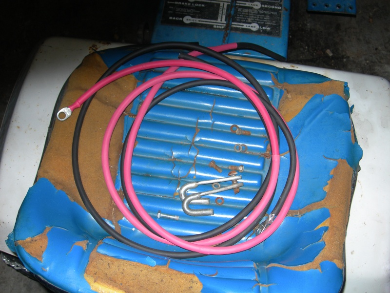

| My rear weight/ battery mount. The battery is a deep cycle gell cell from a wheelchair. Completely sealed and submergeable. ( a buddy of mine tested one in his boat, by sinking it. ) I've since added a clear polycarbonate cover to protect the posts. | |

| Nice lookin tractor. I like the front plow setup you made. | |
