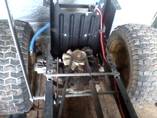

| Todays progress: Got a leakeg setup done so now it can be driven. It now has a hand shifter. I took these pics later on in the day. Tell me what you think. | |

| Heres a better pic of the linkage setup and the hand shifter | |

| The new battery box. Tell me what ya think. | |

| Ok thanks,i will watch the battery for rubbing. | |

| If you see it rubbing, just strap it down tighter and/ or get some foam/ rubber to create some insulation. Head Forum Administrator ** Chat Moderator ** Facebook Page AdminATLTF Facebook Page ** Chatbox ** How To Upload Pictures

| Heres what i got so far it a steering stifiner. I cut it at a 45* angle and then welded it. | |

| Got the steering shaft stifner done. Almost ready for a test drive just need to weld on the steering wheel,and make a throttal. Tell me what you think. | |

| Looks like you are making progress! Steering support looks like it will do the job. | |
