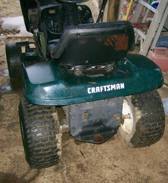

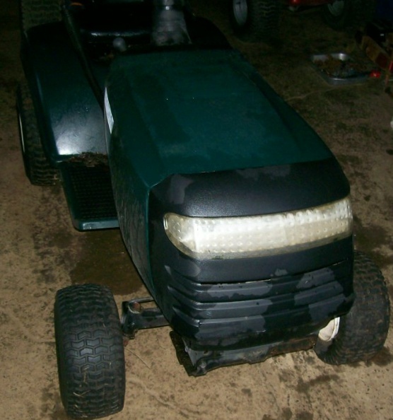

| not sure if its a lt or gt. have not seen it yet and he didnt say. just said motor ran great and trans was stuck in 3rd, but for $50 guess i shouldnt complain, going to look at it monday. hoping its a briggs twin. dont even know about it either.lol | |

| sears has this as having a dana transaxle. i think i can put a spicer out of my old murray in it and shifter will work. | |
Age : 53 Join date : 2010-02-10 Points : 6860 Posts : 1726 Location : Florida, USA
| Subject: Re: transaxle stuck in third gear January 28th 2013, 6:27 pm | |
| Chassis looks just like my weedeater tractor - till MTD took over making newer craftsmans , most the old older LT's are nearly all the same chassis/transmissions - even have a poulan thats the same as the weedeater.
Id still crack it open anyway , that was my thinking back then - it didnt work, so even if i broke or screwed it up, what did it matter? I still have a couple spare transmissions around anyway. | |
