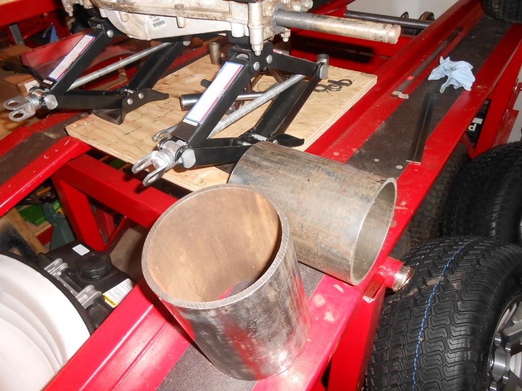

Here's the two pieces of steel pipe for the hubs. Hopefully I'll have the other pieces on Friday and finish it this weekend!
