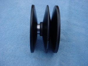

PostSubject: Re: more F N R problems   Wed Mar 06, 2013 7:46 pm
Heres a variable pulley :
There has to be some sort of 'transmission' - unless the trans is a hydro - FNR transaxles have no actual stepped gearing - just forward and reverse - to get any sort of motion, youd need to contantly have your foot on the clutch like a hydro to moderate your speed.
Any way to get pics of this setup on your tractor?
