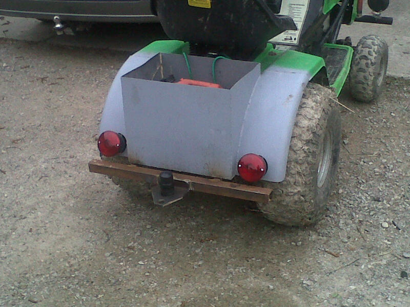

Because I could...
LawnBoy UTLTV aka MULE - Page 5 Tailli10
LawnBoy UTLTV aka MULE - Page 5 Facebo12

do hey work when you hit the brakes

Considering I haven't wired them yet... no. But I could! they are dual filament, and it wouldn't take much for me to wire in a brake light switch. I probably will... 'cuz I can!

if you still have one safty switch you could put it under the brake pedle to actuate the lights

Yep! Either that, or the brake light switch off a motorcycle I molested for parts. I'll probably use that one because they are better suited to longer pedal strokes and are adjustable- so the lights don't come on every time I clutch, and I don't have to totally bury the pedal to put 'em on.

Nice brake lights. Been thinking of adding some tail lights at some point. Rainbow added some led ones to his that look nice, and another friend put on some goofy leds that flash.

LED- Great idea! I have some 1156 LED conversion bulbs around here somewhere. I'll put 'em in, that'll lessen the electrical load!
