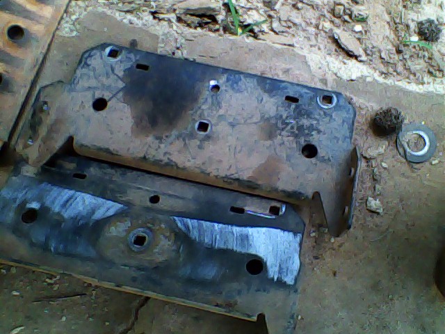

well here are some updates
had to get the front up on the ramps
i had to remove the mounts and drill new wholes
this is the best $20 drill ive ever used LOL
this is how you tell that you have enough lift
is when you can see to the other side
and the final product 2ft of lift Twisted Evil

PostSubject: Re: Sarge offroad/mud mower    Thu May 30, 2013 5:58 am
Looks like you've got some decent articulation now! Get some grease onto those axle plates- you can see a lot of wear on them.

PostSubject: Re: Sarge offroad/mud mower    Thu May 30, 2013 7:06 am
that is the front plate that looks worn its mostly surface i plan on getting some grease zerks to put on that axle plate so i can grease it but the center bushing is pretty much done for so im thinking its time to do what stretch done to his mowers make your own front axle lol
