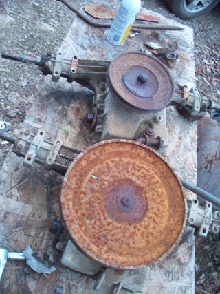

And my transaxles... a 3 and 4 speed. Both have a 900 020 tag.

Torched off the old trans pulleys... Might be able to save that hub.
What do you people think about the possibility of getting these things drilled and tapped so as not to have to rely on them snap rings?

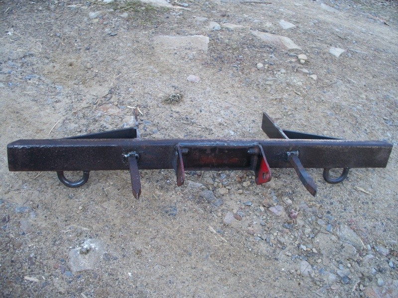

And the bumper... still need to drill some holes for mounting it. The RR spikes might come off. I wont go into detail on the welds... Im not exactly too proud of some of them lol
I like the idea. But it would have to be annealed. Drilled and tapped. Then re-heat treated. And I am not sure you could ever get it back to the same condition.

To be fair, the shafts aren't very hard. Some are already drilled and tapped. In fact, the 930 I just broke had the input shaft tapped from the factory, and the replacement 930 did not. Since I prefer that, I switched shafts.
It's like this- If the pulley is bolted on, I can reach up underneath with a wrench or socket, and get the pulley off easily. Try that with snap ring pliers. THAT is why I prefer it tapped, for what it's worth.
That bumper looks VIOLENT!  affraid
