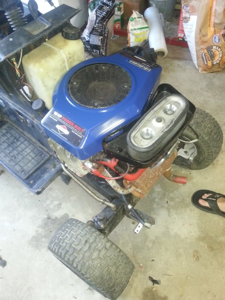

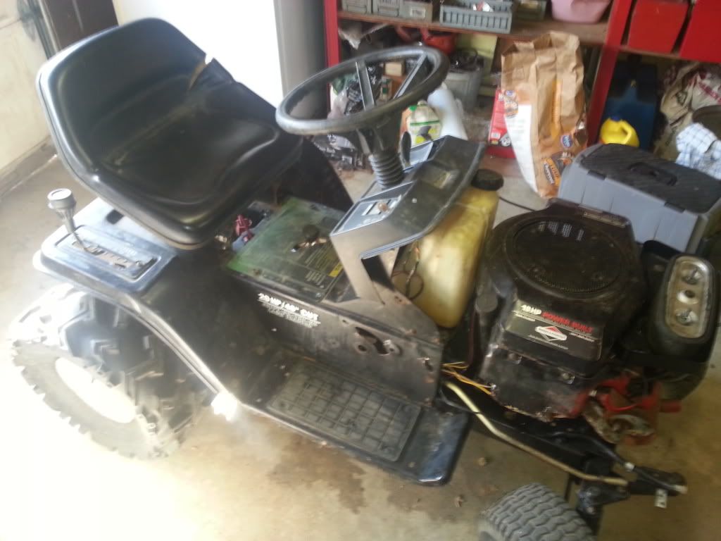

So here is how I got her, the motor was running on 1 cylinder and the right rear tire was off the bead.. Sad
So then, I fixed the tire using carb cleaner, a lighter and a crappy bicycle pump.. Its all i have here at my uncles, then I got bored and seen a sick looking opposed in blue on youtube, but it was missing a sticker on one side so i had to top that and keep both stickers..
Heres an up close of the motor.. still running on one cylinder.. Sad
So.. running on one cylinder.. it barely sparked. so I made a homemade spark plug wire out of 10g wire and insulated it well.. still didn't run.. So i knew it had to be something internal.. and before I knew it was blowing air out of the intake on the carb.. So i thought maybe that valve had been stuck.. Well it was definitely stuck..
There a bolt in it!!!
So i pulled the intake manifold off and popped it out really quick! Bam.. torqued head to spec, and she fired right up.. No internal damage done luckily to the valve..

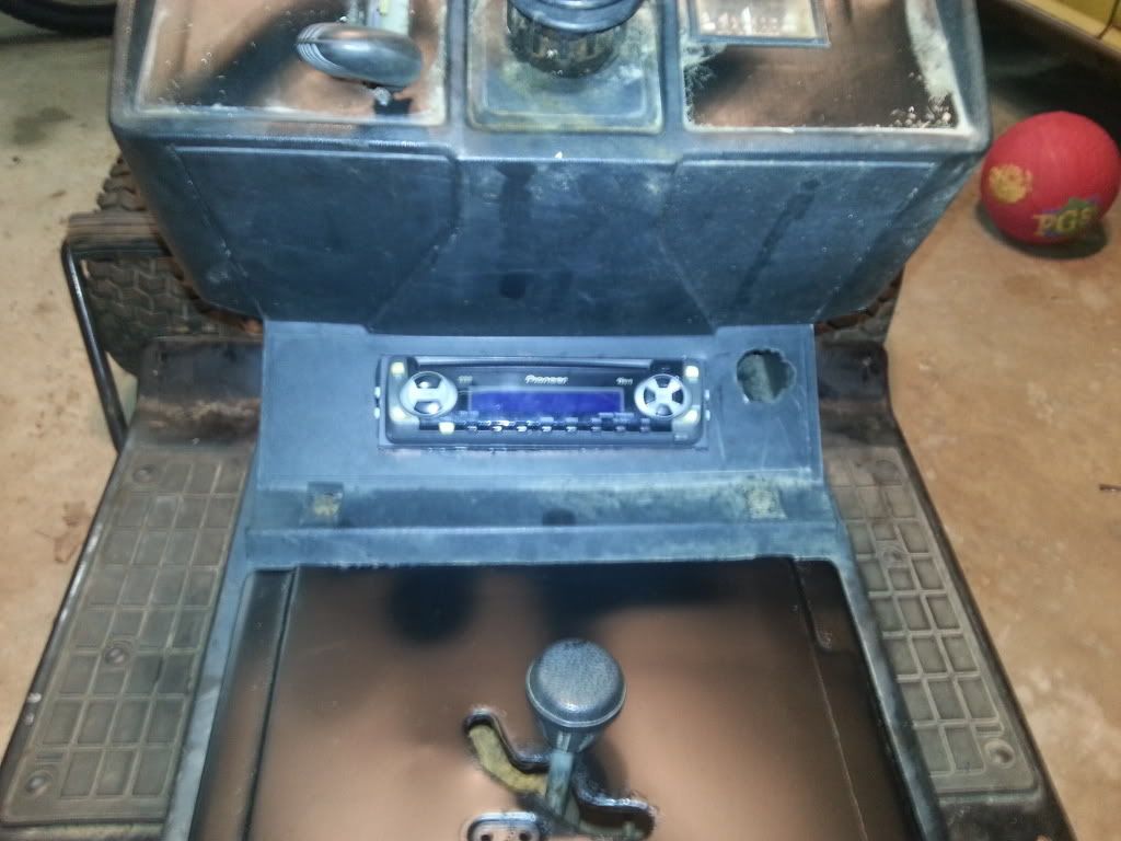

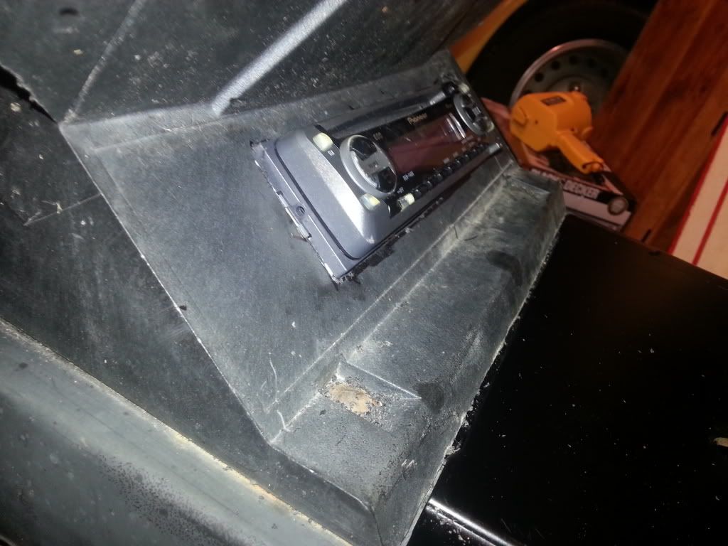

It started to get late so i had to shut her down.. So i started designing a dashboard.. It eventually gonna get tricked out with gauges and toggle switches (under glow!!) Also, push button ignition may be getting a transport if this fails.. So anyhow I found an old pioneer radio and started fitment!
That all for now.. TO BE CONTINUED TOMORROW!!lol!
