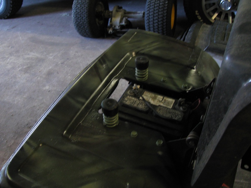

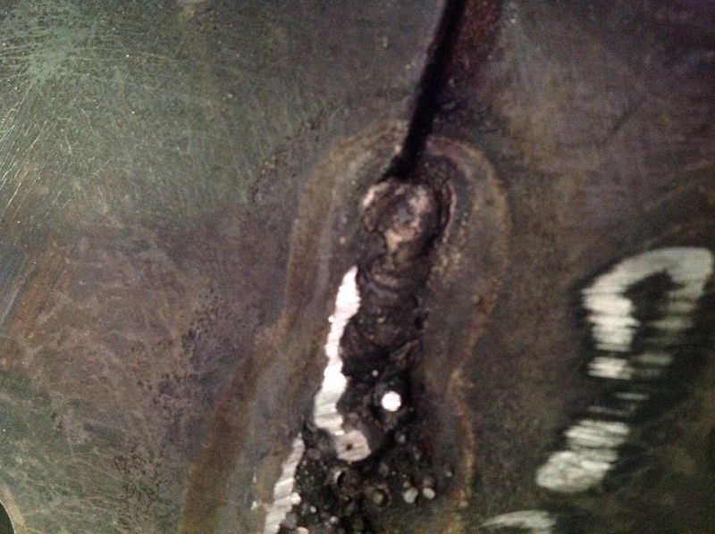

| Got some work on the John Deere (MTD) I didn't like how it nose dived even with the 16in tires in the front, so I decided to do something about it... Now, the rear has a 3 1/2 in lift block (a 2x4 pressure treated block lol) and the inch taller front tires added a half inch to the front so technically I needed 3 inches in the front to level it out. With four inches difference in tires considering. So I went with a 2inch lift because now I should be able to run 16s or 18s in the front without to much lean in either direction here's some pics Wish all the welds looked like that lol View of the angle on the steering part https://i.servimg.com/u/f70/18/54/01/72/image20.jpg}" border="0" alt=""/> Some fender mounting hardware Painting them up https://i.servimg.com/u/f70/18/54/01/72/image22.jpg}" border="0" alt=""/> Alright I know this isn't a truck forum but maybe one of you guys can help me out, just wondering if this is too much angle on the CV axles.. A key lift with the bolts all but two turns out.. Hardly screwed the tighter because didn't want the angle to bad, it's about 2 inches higher then it was just wondering what y'all think | |

| Are those two little flat plates the only thing holding that front axle in? If so, I might suggest further reinforcement, With regards to 2x4's and other wood fixtures, I strongly suggest upgrading to steel the moment you have the chance. Wood and tractor don't mix well.
Get that stuff sorted out and you're off to the races! | |

| Subject: Re: MTD mudder October 5th 2013, 8:49 am | |
| - Doc Sprocket wrote:
- Are those two little flat plates the only thing holding that front axle in? If so, I might suggest further reinforcement, With regards to 2x4's and other wood fixtures, I strongly suggest upgrading to steel the moment you have the chance. Wood and tractor don't mix well.
Get that stuff sorted out and you're off to the races! Agreed. Maybe bars that come down from the frame to the axle up front day a 45 degree angle. | |

| Subject: Re: MTD mudder October 5th 2013, 11:06 am | |
| You can jump on the front end and the rear all day shake it every direction... I'm pretty ruff on it ... I'm extending the front mounts on the tranny but as for the blocks, there stayin because I haven't had a problem with them. Now on the other hand if they break I'll put some steel in there. Also on the front I will be adding a little more support just for good measure thanks for the concern though! Haha | |

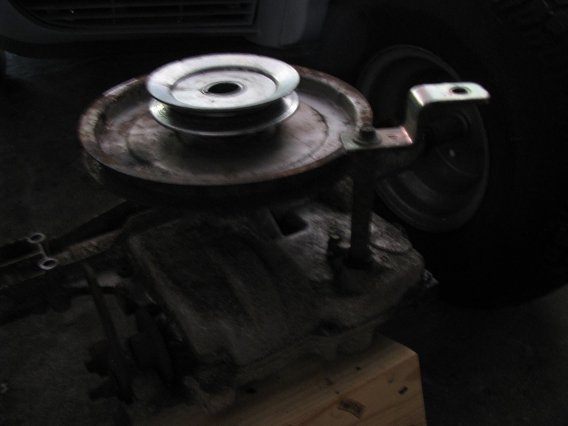

| Subject: Re: MTD mudder October 5th 2013, 6:05 pm | |
| got a little suprise for the deere... its getting a upgrade from the MTD tranny to a spicer 6 speed out of a murray... the murray will be another project that i plan on making bullet proof and big. a peerless 820 tranny and a big Twin Briggs. but for the deere this trannyt should be good. i have to get more weldin wire to make some customs mounts considering the new tranny mounting holes dont line up with the chasis ones... heres some pics. just dropped the tranny... lift blocks still hangin out lol just a pic of the fenders i painted mounted on the tractor heres another one heres a pic of the tranny, thats the pulley im going to weld to the old pulley so i can keep a lift on this thing its a 4 1/2 inch pulley, i should get some pretty good speeds from this thing now the shifter is in the same general area as the old mtd.. so still might have a nut buster shifter | |
redlinemotorsportts Moderator
Age : 27 Join date : 2013-03-18 Points : 7267 Posts : 3131 Location : raleigh nc
| Subject: Re: MTD mudder October 5th 2013, 6:23 pm | |
| Looks good nice upgrade. Those wood blocks scare me. | |
GenevaCustoms Member
Age : 27 Join date : 2013-09-24 Points : 4199 Posts : 315 Location : Florida
| Subject: Re: MTD mudder October 5th 2013, 6:42 pm | |
| Lol, nothing to be scared of. Just make sure you don't use normal 2x4s... They need to be pressure treated and like top of the line otherwise it would probably split... Either way it's getting a big time upgrade in my opinion. It will be alt better all around tractor without just one forward gear. | |
cumminsbayou Member
Age : 26 Join date : 2011-11-04 Points : 4805 Posts : 232 Location : fairhope Al.
| Subject: Re: MTD mudder October 5th 2013, 6:53 pm | |
| Sweet, gears are all was better when it comes to mowers lol. Remember to cut the old pulley down so it don't cut the belt like on your rear engine rider again. | |
| Subject: Re: MTD mudder October 5th 2013, 6:56 pm | |
| This one clears lol it'll be ok and I'll paint up up nice and thick so it has no sharp edges and I might run a fender shift if I can mount the old horizontal shift linkage from the Murray,or just make a nut buster,... Or one under the seat like on mud kings what you guys think? | |

| Subject: Re: MTD mudder October 6th 2013, 5:28 pm | |
| your camera was upside man.....-_- lol, but yea, it needs a x-brace or else it might go sideways on you | |

| Subject: Re: MTD mudder October 6th 2013, 5:29 pm | |
| The front of the axle has to be supported. Theres screw hole on the side up front. you risk cracking the case or the axle driving underneath it. | |
