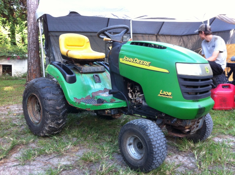

Just got this thing for free it's a jd l108 it has an 18.5 briggs on it. I got it to fire once then shut off.

Alright still no resolution of the fuel issue but I added some upgrades Smile
Also can some change the name of this build to THE MARSHMASTER John deere
Before
After said upgrade
Rear view
After said mud
After said mud rear view

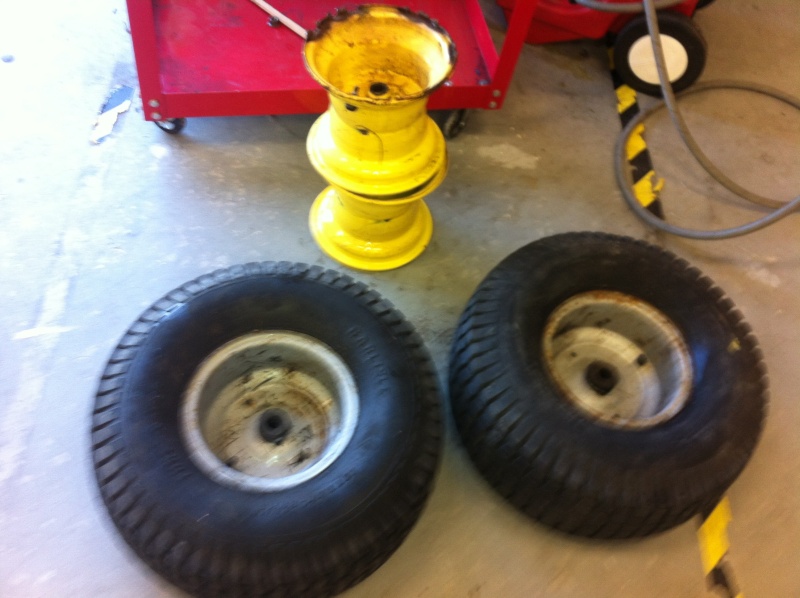

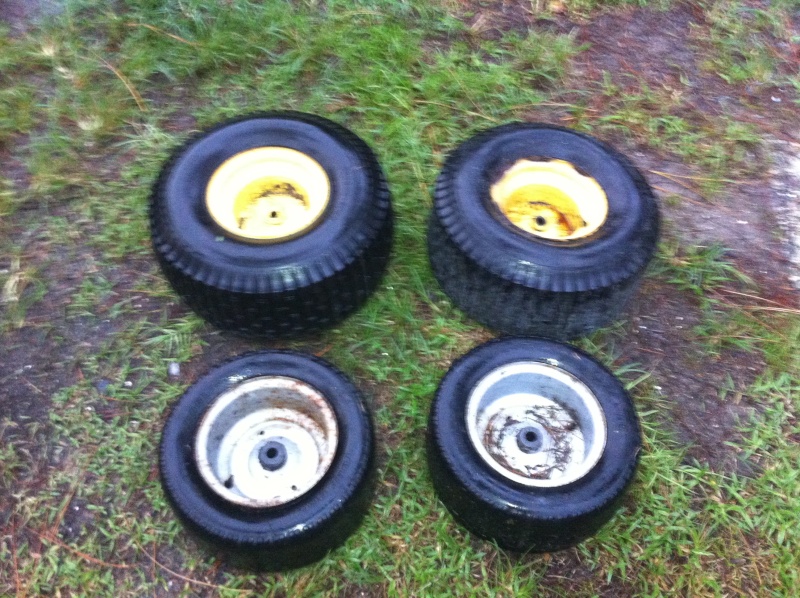

New tires for the front
Join date : 2013-06-19
Posts : 1135
Location : Southern Florida
PostSubject: Re: The Marshmaster John Deere   Tue Oct 08, 2013 8:27 am
Got the new tires mounted up and I will install them after school!
Also I'll get pics after school
