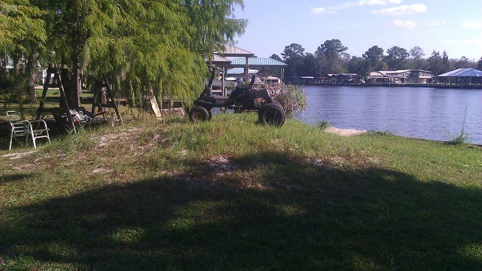

So here it my 2002 murray RER. Stock it had a 930 or 920 peerless, 14in rear tires, 11hp briggs, and 9in front tires. Since then it has evolved in to what it is to day.
Here are the mods
The motor has a 16hp briggs carb on it
6in engine pulley
3.5 transaxle pulley
new metal idler pulleys
more clutch springs
20in turfs in the rear
15in tires off a murray
a hole different fron end from a murray
swapped in a 5 speed spicer
Lifted 1.5in's
Stretched 4in's

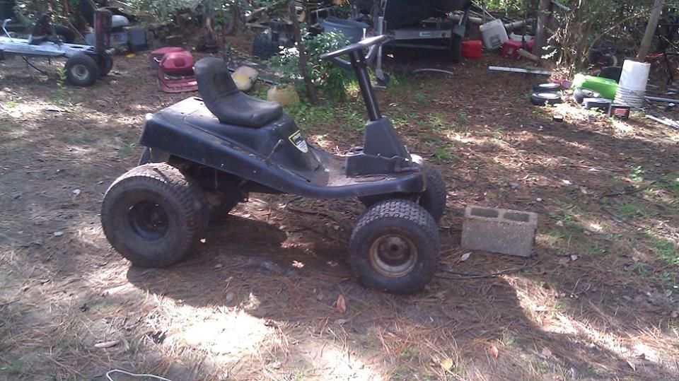

Here how it was with just the deck off a few years ago
I quickly put bigger rear tires on it, but because of the 5/8 spindles on the front i couldn't put bigger tires on the front with out some modifications
mock up from years ago
It has been out of commission for 2 years, just got it running a week ago but the motor threw a rod lol. I'm rebuilding it now.
Thats with 18's up front
Thats after it was stretched

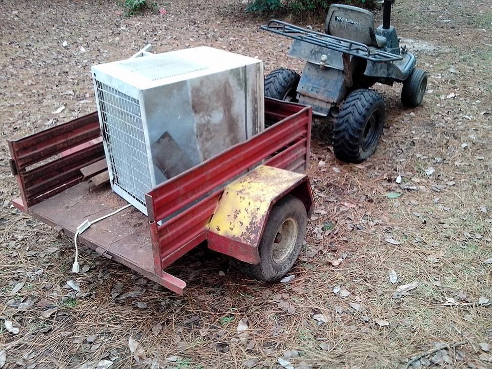

PostSubject: Re: The Swamp Rat   Sun Jan 05, 2014 10:49 pm
I went ahead and got a new belt for it today. Motor still runs awesome started on the 1st pull after 3 weeks of sitting.
She did some working today lol. Thats a old window unit and on the bottom is a hole bunch of scrap steel for my build off mower and stuff. I found the window unit in the trash lol.
Need to do more work to the rack and fender flares/mud flaps still.
