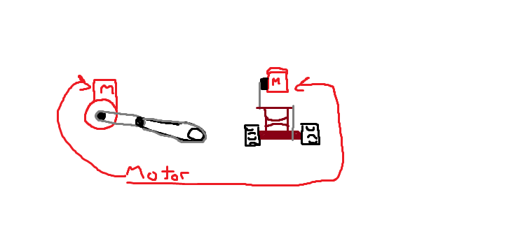

Posts : 883
PostSubject: Re: LMM's Rally Mower!   Mon Mar 17, 2014 4:37 pm
HUGE UPDATE!
I made up my mind on what I am going to do (FINALLY!!).  I will be getting a peerless 820 and putting a doc-locker in it (hopefully with a high speed gearset).  I am in the process of making a front axle out of one from a simplicity zero-turn.  I will cut it down and weld the spindle tubes from the original axle to the axle and bend the spindles with the torch to match my caster/camber needs.  I will go through the steering box (which is surprisingly really tight) and will be redoing it properly for racing/offroading needs.  Until I get the 820 I am running the original tranny which is a peerless 920/930.
That's all I have for now!

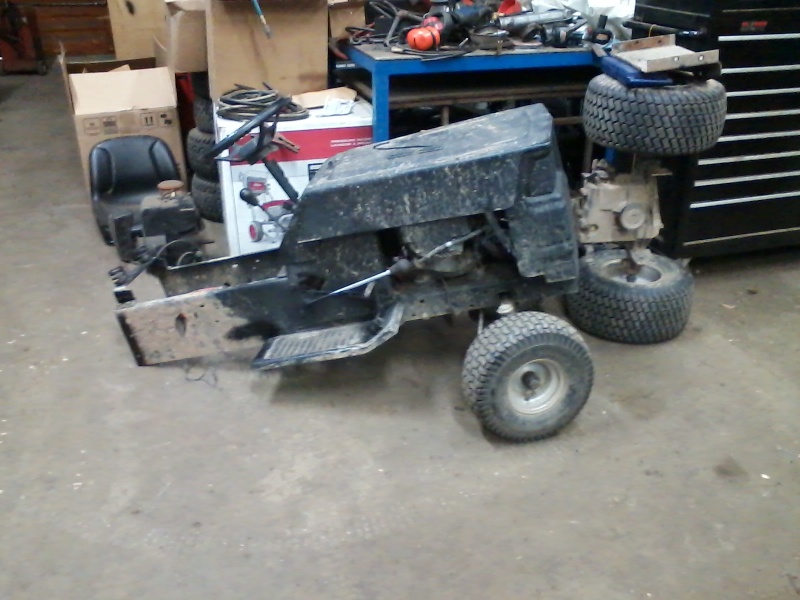

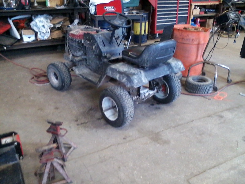

OK OK OK! Here ya go:
Took 'er home.
Got it back trying a new gas tank but it didn't fit so..
decided to do moar stuff.
DOC LOCKED AND READY TO ROCK!!
Dat stance!

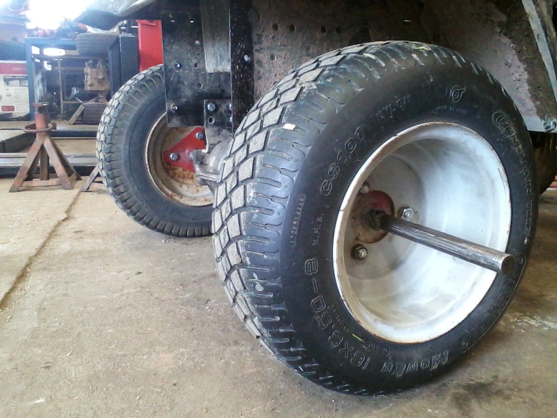

Snapper RER hubs (Two LH ones) welded to the axle

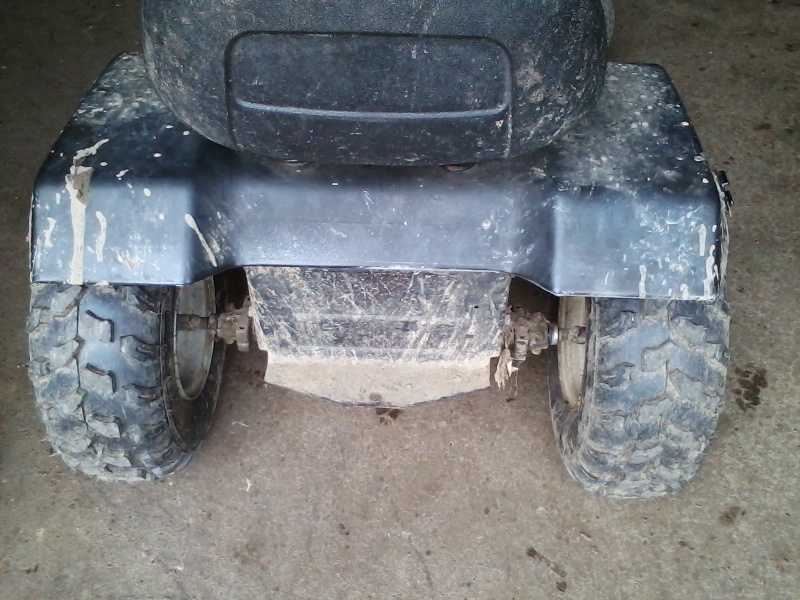

GUESS WHAT I GOT IN THE MAIL!!!
Climbs hills like nothing...
Maybe possible front tires? 15x6-6 Carlisle Snow-Hogs. I like these better that the 16'' tall ones..
We are getting there in just over a month left.
