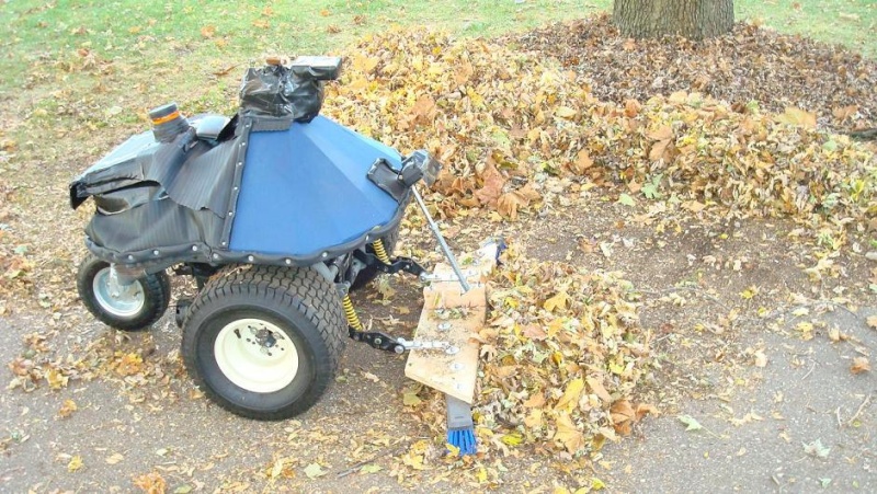

Not sure if this is on-topic, but.
would you call this a cordless lawn tractor?

Jamus, truth be told I have given up on that arrangement for mowing. seems to work ok on hard flat surfaces(like plowing snow) but fails at
tasks like mowing uneven terrain or loading in a pickup truck.
Edit: just because I can't get it to work, don't mean nothing.
By summer I hope to test a controllable direction fixed wheels in the rear.

I do have a test mowing deck that I used for software development, a earthwise 24Vdc electric. but it's only
20", this winter my hope is to finish the 48" deck, I also have a rotary brush attachment for moving dead leaves.
I tested a broom attachment that I didn't like.

It mowed only eight times last season (it's @five months old), with the earthwise mowing attachment. all attachments
attach the same way(3 pins) .
below is what the 48" mowing deck may look like with a drive motor and not wheels(casters).

With the mower attachment a 20deg slope is all I have to test on.
But when loading in a pickup truck it climbs a 45deg slope with out straining a drive.

dangeroustoys56, it is both, doing things like loading into a pickup is best with a small palm sized keyboard.
right now plowing is done with Wifi connecting the house PC to the Mule's PC, but before the end of this winter
I should have a programming mode for that, mowing and dead leaves is programed.
