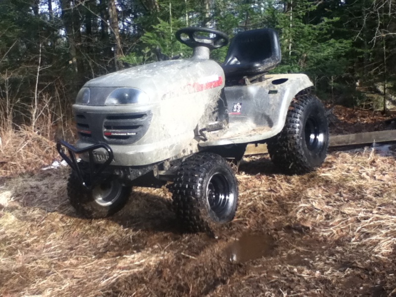

here's what half a can of black spray paint will get yah lol
Craftsman Lt2000 Project - Page 2 00215
to me its a big improvement in the looks department.. All i painted was the wheels, reflective tape in the headlights, and the bumper (sorry richie chrome wasnt working for me) but the next thing that is a must for me is the brakes...that will probably get done sunday seeing that i am busy for the next couple of days

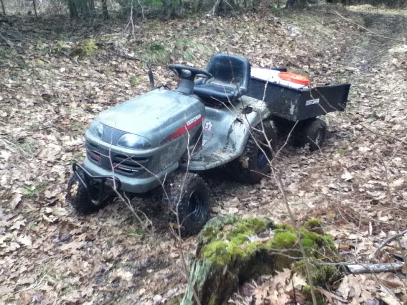

i did some work in the woods and man trailers act like anchors

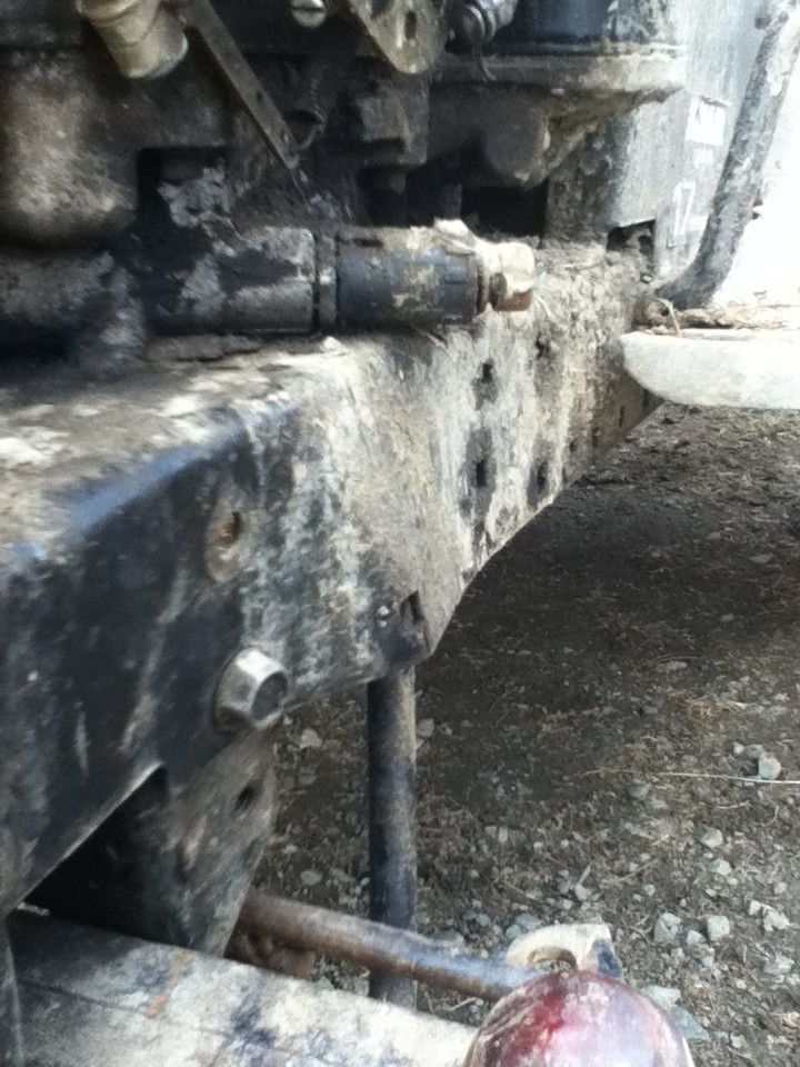

i noticed that my frame was really tweaked the other day so i hammered the frame back into the proper shape

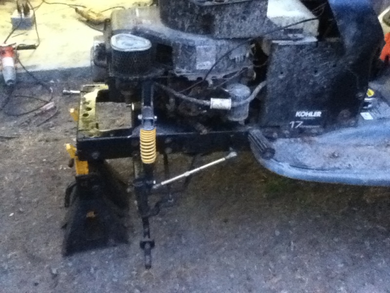

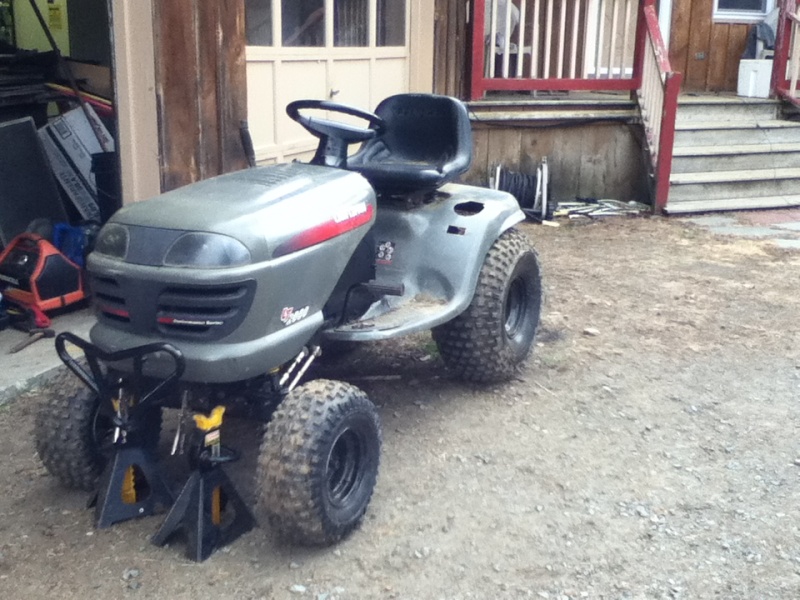

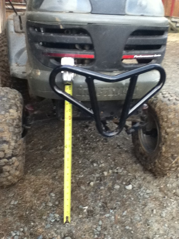

i had already lifted my tractor in the front, but the way i had lifted it was all wrong. so i redid it to see the old lift scroll up or go back a few pages. the way i lifted it this time was just simply drilling a hole through each mounting plate
Craftsman Lt2000 Project - Page 2 01110
its not heigher in the front, just a bad picture
Craftsman Lt2000 Project - Page 2 01210
a basis to see how high up the tractor sits now

so last week i discovered that the front end of my mower just kept falling apart so i figured it needed something more than the not so great stock setup....i had plans that i had came up with a month ago but just didnt have the motivation to. i saw CornShuck4CE's setup and noticed that i had all the parts necissary to build this
Craftsman Lt2000 Project - Page 2 Hhjk10
a sketch i did a while back
Craftsman Lt2000 Project - Page 2 007_210
the mockup of this design
Craftsman Lt2000 Project - Page 2 008_210

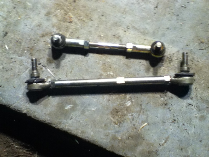

the tierods off of 2 chinese atvs became my links
Craftsman Lt2000 Project - Page 2 00312
front view of the set up minus the pan hard bar
Craftsman Lt2000 Project - Page 2 00113
the side view of the links
Craftsman Lt2000 Project - Page 2 00416
the final product. i had to push the front axle up about an inch and a half. i also gained about 1-2 inches of combined lift. i have yet to go off road with this set up and i can guarantee that something will go wrong but everything currently seems solid.......for now
