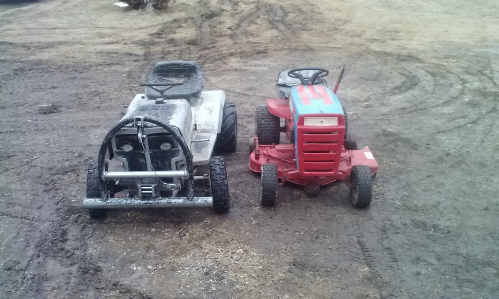

New toy, mild build, maybe 25mph, locked rear end, bigger fronts.

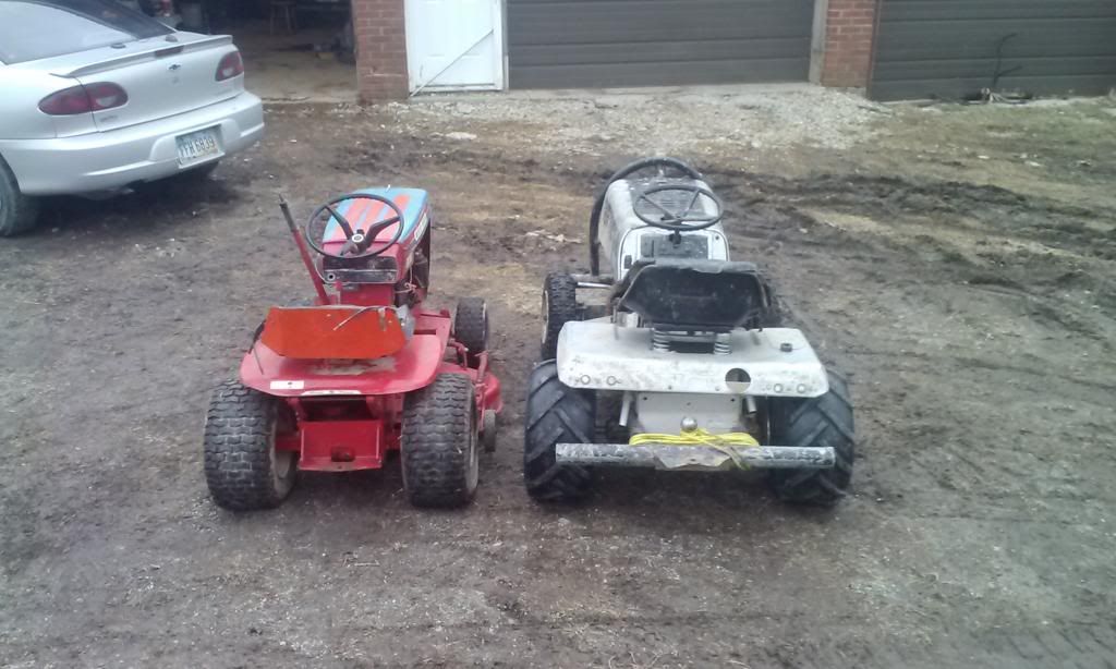

Also getting a gas pedal, and governor disconnected. Deck is getting sold, and all deck hardware removed. Adding a recoil to it.
Got it to run!  Puttered around the yard some, probably could fix couple little things, and mow with it!  Steering is the best stock steering I've seen, it's tight, smooth, and turns sharp.
Pics of a size comparison to the silver bullet.  It's decently smaller, not quite a mini, but still small.

This was wheelhorse's heavy duty vertical shaft lawn tractor.  Later one's had a 600 peerless.  I think this is the smallest mower you can get with 1in axles.  It's a 5066/5077 wheelhorse transaxle. Diff is a worm drive, but not like a standard worm.  Picked up an extra transaxle for 30, it's locked up at the moment.  The are all gear, cast iron, bearings, oil filled.  3 speed with reverse.  Has a nice band brake on the pinion shaft, on top, should be out of the way of dirt and mud.
If these tranaxles don't work out, I'll swap an 820 in at some point.
Originally it had a 7hp tecumseh. 11hp runs nice, need to upgrade the coil to get rid of the points.  Thinking a rear exhaust, chrome tip.
Paint on hood is redone, rest of it may have been painted at one time.  I want to put a stock paint job on it, and make it pretty....
