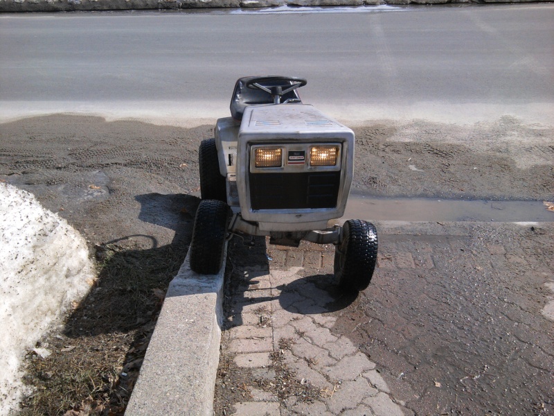

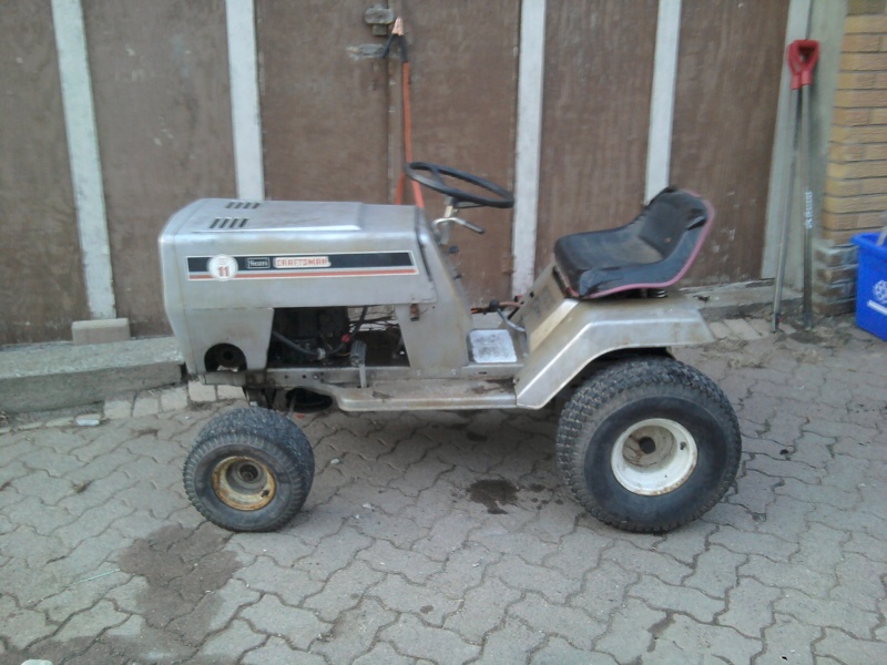

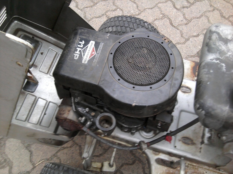

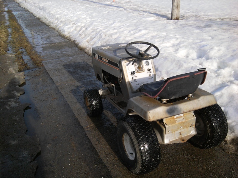

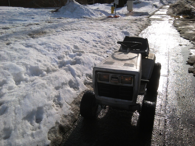

| I posted a wanted ad for a used tractor on my local kijiji, and a couple weeks later, got a reply. I drive about 25km [15.5mi] north to pick it up, and got it for $50. He didn't have a good battery for it, and I never saw it run, but given that it had compression, and had good oil in it, I figured it was worth a go for 50 It's got an 11HP Synchro Briggs, Peerless 814 5-speed, no deck, and had some carb and wiring issues. Runs and drives great now! Here it is after unloading it at home After some carb and wire work, IT LIVES Went for a SLOW drive down the sidewalk, going through gears, etc. IT was a very nice day, first spring-like one balmy 67* Returned home, and as I'm pulling into the driveway, I lose my steering. Turns out the first control rod fell off the rear ball. Worn out I suppose... Here's some more pics as the sun set further, and ended up bringing it inside. MORE TO COME, let me know what you think happy spring romping! | |

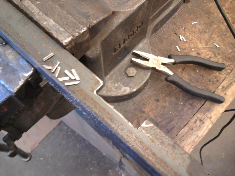

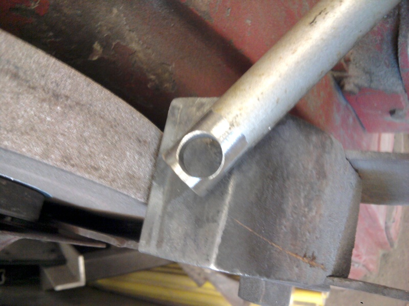

| Going to try a simple but effective fix for the tie rod today at school... Drilling out the ball recesses, and putting a bolt thru them. I'll just secure the bolt with a couple jam nuts and I'm all set. Till I do a direct steer setup or something The rod I'm talking about runs back to front and is seen in the last photo on my bench. | |

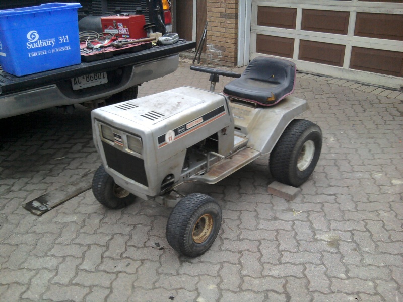

| PROGRESS So today I fixed the tie rod issue - as I said in an earlier post, I planned to drill out the ball ends so I could loosely jam-nut-and-bolt the rod to where the balls mounted. Took it for a good drive around, put a governor spring on it so I had full 3600rpm speed... as far as a 4or5:1 stock pulley ratio goes... Then I brought it home, and started ripping and tearing. The photos tell a better story. In short though, I'm taking it to school where I can weld in reinforcements in the unibody pan frame, and also pressure wash it so it's a bit nicer to work on. Might also be adding a bumper or foot throttle.... Time will tell. The Tie rod modification... Little stock crawl on the remnants of snowbanks Little baby stock flex on the driveway curb.. a whole 4" of articulation... And it's here that I start taking it apart. Here's the transaxle seconds after I lifted the chassis and engine off it Check out the rot on this input pulley/shaft... I need some advice on the situation I have with my right side axleshaft... Check out the up-down play in that... Other side is ok, but either way, once the pulley's off, this trans is coming apart Truck loaded, ready for school tomorrow. Packed nice and low since we're supposed to have rain tonight... Want to unroll the tonneau cover for the night. Everything in there except the hood. I've got a cherry bomb that was included with the trade for the mazda b2500, might make a stack for the Craftsman, using flex pipe and an aux mount so I don't rip my engine block if I roll... What you think? | |

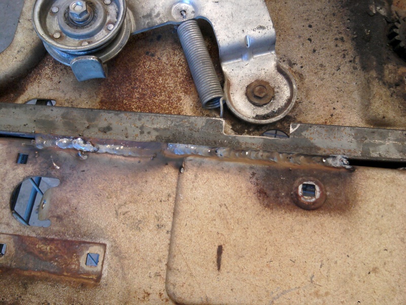

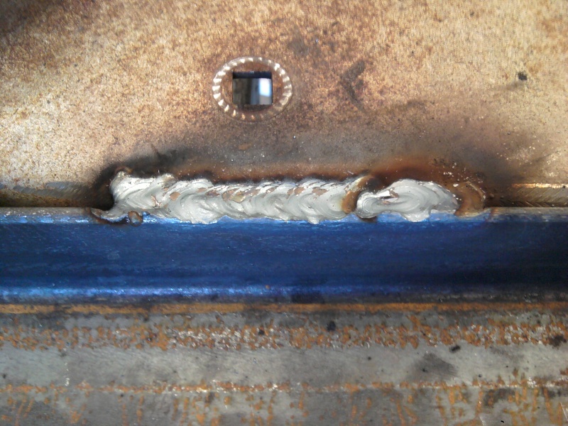

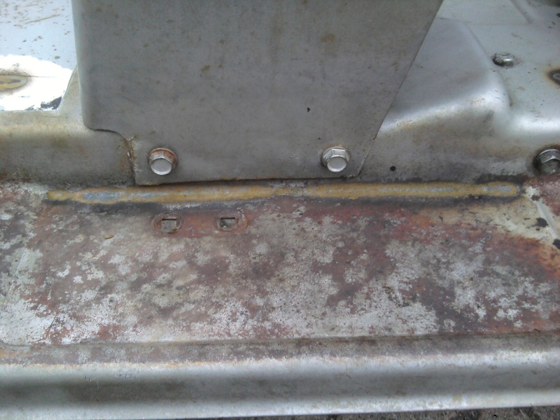

| So after a brief bit of inactivity... I found my phone cable so it's time for pics and other nonsense. So Immediately after buying this tractor, my first thought was to reinforce the chassis, which is the 14ga stamped pan type. So The following photos show the process from being in my truck to reassembled in my driveway tonight. Regarding the sketchy trans and input pulley: I split the trans after smashing the rusted pulley off the hub, removed all bolts, came apart like nothing. Nice inside, nothing broken, removed the snap ring from the input gear, pulled the shaft/rust welded hub out of the top half. I'll just buy a new input shaft and associated needle bearing so I'll have no difficulties down the road. I'm also getting new outer axle bearings, though only one [right side, seen in earlier pics] is worn. Anyone know offhand if an 814 is oil or grease filled? Also, I removed the engine pulley [3" wheel drive, 4.5" deck drive], and this engine has the 7/8" / 1" stepped crankshaft. Bought a Princess Auto 6" weld on pulley, but waited on the hub since I was unsure of the crank size[s]. Wheel drive pulley center measures 2 9/16" from the bottom of the cover, so I gotta get a 7/8" hub and weld the pulley on. I'll just get an aluminum 6 x 5/8" pulley for the trans after I get the new input shaft. At last that's it for pics today. Let me know what you all think of the progress and any suggestions/questions you might have. | |

| So I've got the whole thing together, and I've got the two kinds of news, meh and bleh. Meh news is that I'll get some riding time in before you all get bored of this build and move on to others Bleh news is I have to re fab my hub/pulley design on the engine end so I don't have belt binding issues. Once it's driving I'll see about borrowing my brother's goPro to make a POV ride video. As far as updates, I've changed the engine oil to straight 30 shell stuff, bought a 24$ walmart battery - 180cca, and re attached my wiring. I've also welded the front trans mount in so my tranny won't twist back when I get to riding [peerless 814s are mounted by u-bolts on murray chassis, plus one bracket supporting front left corner]. I still have to make up a gas pedal setup, but can't find any of my old bike parts might weld one up outta metal in school. | |
