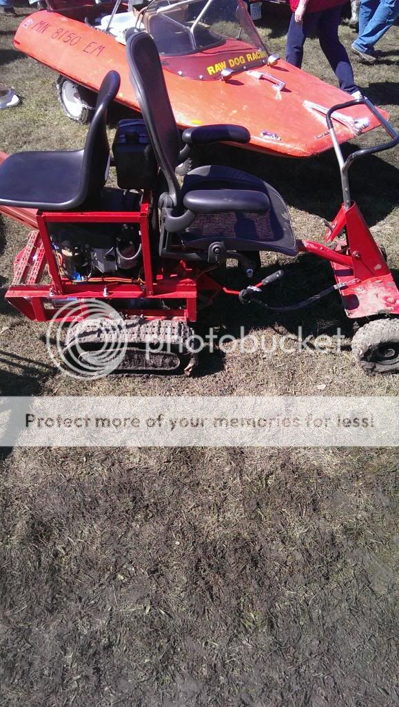

Here's a rig I snapped a picture of I don't think it was for sale.

im pretty sure mst 205's have 3/4 inch axles and that "thing" you saw at the auction looks really funky....like one of those tracked wheelbarrow things mixed with an old rear engine rider

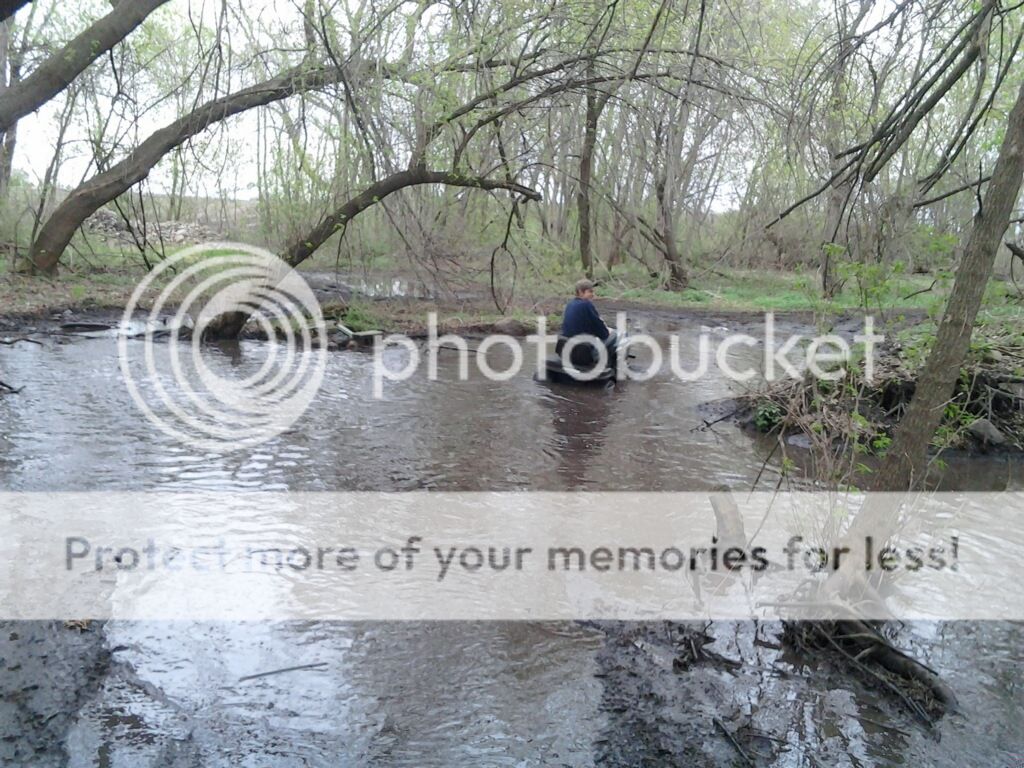

Got to ride today, went through the mud great, pushed over a bunch of trees with my bumper and a lot of brush, banged up the skidplate for the exhaust, and had a branch push the pin out of my tie rod, all good now here's a pic of the mud pit.
Oh and broke the weld on my locker, do you guys suggest welding the spider gears to each other too? The trans still worked so I don't think damage was done.

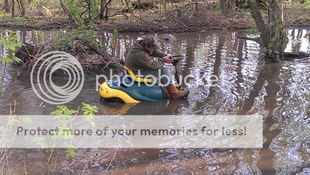

The craftsman got a bad ground while I was riding in the woods today so I had to jump it after I shut it down, had to do a lot of head scratching to figure out why it wouldn't turn over. Finally jumped the neg post to the fender pan and bam!
Enjoy the pic of a yard bug in the mud.
