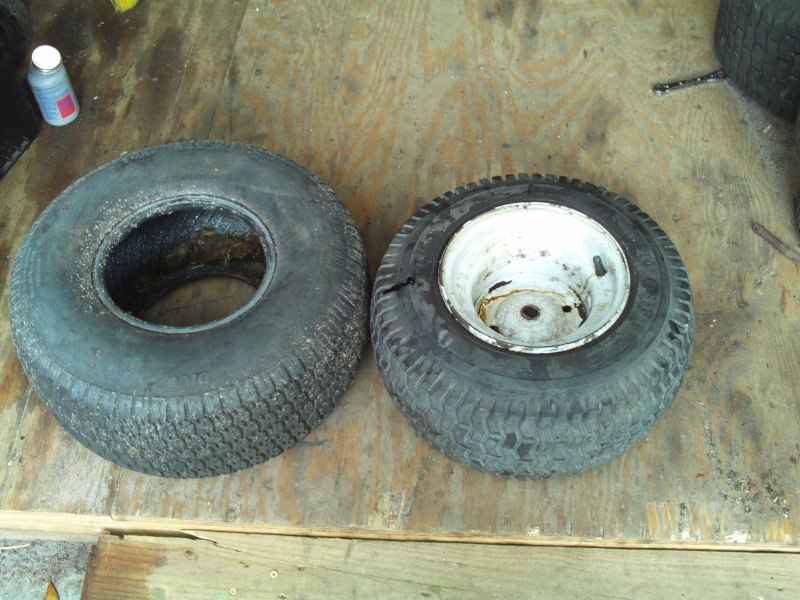

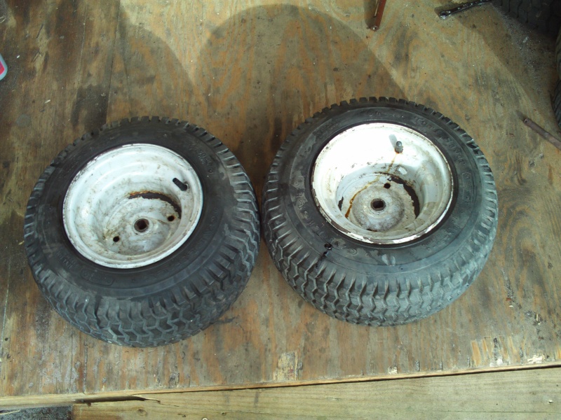

More updates! Stopped at TSC today and bot a tube for the other tire and put it on and aired it up. Also snagged some pics and a short video as well- heres the pics of the progress:
Pulley i welded to work on the transaxle:
Tire difference between old n new:
Bare bones MTD transaxle:
Frankenstiens monster......
Finished wheels:
Itll still need alot of work, probably will need a couple new belts, then all it needs is the 14.5HP OHV briggs on/hooked up and its ready for a spin.

Like the stretched tyres. Reminds me of a Euro Styled VW! WIll be nice to have something to beat on. WHo knows, you may find a good place to go mudding and turn this into a full on mudder some day!

It was funny- it ddint occur to me about the width until i put em on and went - " Ooops...Ill make em fit..." . The tubes are actually bigger then need be - if i used the small tire size, i dont think the tires would bulge to the rim , so i got slightly bigger .
I thought it looked sorta cool using those narrower tires- haveta see when i put the trans back in- i might be able to get away with a couple straight zerks- wont know till i get the trans open- might even put a zerk where the main drive gear is as well- overbord on grease is better then locking it up- specially if i do some rough break in time with it. affraid

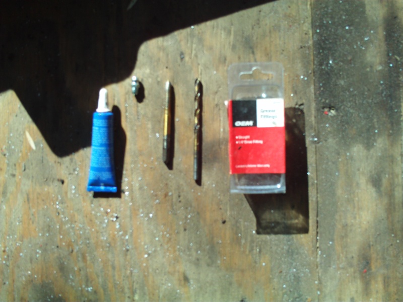

Finally got some time in the shed again today- i cracked open the transmission and checked it out, actually had some normal grease in it. I had planned on adding gear oil to it, but instead i added a few good squirts of lucas oil, and added the zerk fittings :
After looking the case over i noticed two breather vents in the bottom of the axle tubes- so i drilled those out, threaded em and stuck the zerks in- easy access underneath the axle and theyre pretty well protected too ( could always add a piece of metal over them)- the 3rd i added to the left top of that sticker on the case in the pic- i checked clearances and fit perfect- i did have to lightly grind off the zerks in the axle case tho- the axle touched them and i didnt want to cut a groove in the axles fearing i may break them roughousing the tractor around.
Heres the pieces i needed to actually do the process:
left to right - locktite blue, 1/4" zerk fitting ,1/4" tap ( inserted into the drill motor) , and slightly smaller drill bit .
I took the broken trans out, was putting the redone old one in and....the pinon shaft comes out...the lil clip came off the end- so took it ALL back apart and fixed it, then put the trans in the tractor.
To cure the sticky axle ends i lightly ground the axles down just ever so slightly and never seized the hell out of em!
I still need to get the proper rear belt- cant seem to find one around ..... pretty soon itll be ready to roll!

Great Idea putting one on the ring gear. Did you seal it up anyway? I'm gonna try this on the peerless that came with the tecumseh craftsman. Unless it's oil filled. This looks like it will go a long way to increasing the tranny's longevity. Any idea what size that drill bit was?

id have to look at what size the bit was- the tap will make the hole slightly bigger anyway.
I didnt use any sealant on the case- it has a small lip- since i wasnt using gear oil i figured id leave it,if the case halves are flat id use RTV for a gasket material - altho when i cracked the case open after greasing it, some of the grease went into the lil hollow pockets to the side of the axle - ill have to slowly rotate the axle when i fill it n see. I used Lucas oil grease, Lucas oil wheel bering grease and squirted a generous amount of lucas oil additive in it to make it nice n sticky. Oddly the original grease didnt look that bad- a few darker areas- but mostly looked just like regular wheel bering grease ( what little there was). I thought of adding another fitting near the input shaft - but there didnt seem to be any room ( where it wouldnt interfere ) - at least where i could reach it w/o removing the trans- now i think about it, could probably reach it from the battery tray area.....ah well- ill see how this works.
I trial fit the axle/diff unit in the case and saw there was a nice gap in there to sock the grease in. cheers
Oddly enough i came up with the idea of adding zerks when i had the deck off the GT6000 on the 86 GTII- i was like " how do i keep those mandrels from seizing? " - so drilled n tapped em - hopefully some grease will work its way into the berings n save me several hundred dollors in mandrel replacements.
Im thinking ill add a few to the 97 mower n maybe my others as well - at least in the gear area.......that 97 howls like a banshee....
