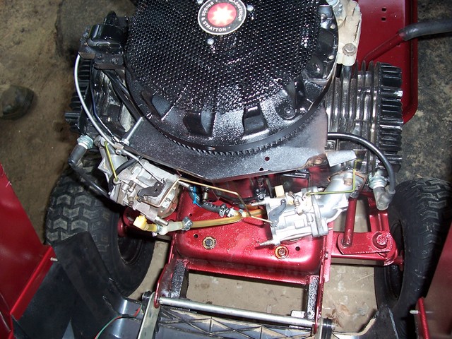

Im letting the MTD sit for a a couple days while i think of a way to fix it- i drug the 88 kleen kuts 18HP twin in and ive tinkered on that- had the twin carbs all hooked up n working ( with the governer) - went to take the one carb apart n broke a piece inside it - ill have to dig around to see if i have another one somewhere .....i might use a old style one piece carb on the left and a newer one on the right- ill haveta tinker more on it.

You had the twin carbs hooked up? affraid man, this I wanna see!
PostSubject: Re: Mild Mod MTD   Tue Apr 13, 2010 4:06 pm
I was so frustrated when i screwed that carb up - i didnt get pics - yepper it actually worked( by hand- motor isnt actually running yet)- had the governer and chokes even hooked up - running it the way i wanted- well ill need to probably take a carb off one of my other tractors .
Only issue ill have is hooking a set of air filters up- theres NO room with those linkages in place- ill figure something out.
Couldnt tell y how many times i had to take the whole setup apart to adjust, bend and tweek the linkages- i worked on it for about 4-5 hours to get it right.

hoooly Shocked that thing is awesome. Bet it sounds amazing, and responds really well too.

that thing is soo sick dude, cant wait to see a vid

So yesterday i decided to take the carb off the mild mod MTD - tried various carbs and remembered i had that 16HP teccy motor on my bench - so took the carb off it - and it nearly matched perfect to the briggs intake - just had to open up the carb mounting holes a lil bit- so manged to hook it up, and tried to start it.....and start it...and start it.... gas would go into the float area but not to the intake , cleaned it numerous times and manged to get it running ONLY if i put my hand over the end of the carb- eventually i did find some other carbs in a bucket - took the teccy carb off and put one of those i found in the bucket on - it runs with the choke on- so ill need to tweek it.
I didnt have any time to work on the twin carb engine- after messing with the MTD for a few hours- BUT i can set it up the way i want now. I wont have time to tinker out there least till friday/saturday. Once i get the carbs setup, then can hack the crap off the end of the crank and bolt my 5" pulley on it, slap it on my murray n see if the bad boy runs..... to be continued.....

That twin looks cool! I'd like to hear that thing running! ITB' are really cool, bet its picks up a little throttle responce once you get it all dialed in.

Im thinking itll run pretty strong - one carb wont have to feed two cylenders anymore- but itll probably use gas like crazy tho.

I should think it probably will, although, that said, it may not. The stock carb has to feed two cylinders, with a carb on each, they arent having to feed as much fuel in. Although it still probably will use more, I dont think it will be too much of a difference
