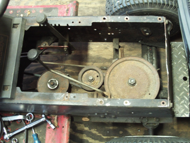

Variable pulley in a MTD is actually the transmission- depending where you place the shift lever and where the belt rides on the pulley setup depends how fast or slow it goes.
Heres mine on the MTD - its the first pulley on the left: tranny question File0015
Heres what it looks like :
tranny question Mtd_va10
Where the center part of the pulley is detirmines the position of the belt - sorta like a centrifigal clutch on a snowmobile - further down inside the pulley, faster it goes - the center part slides back and forth and the whole thing rotates.

oh haha thats weird looking. glad i just have a transaxle setup

yeah its a weird setup - only my MTDs have it- the rest of them have 'regular transmissions'.
