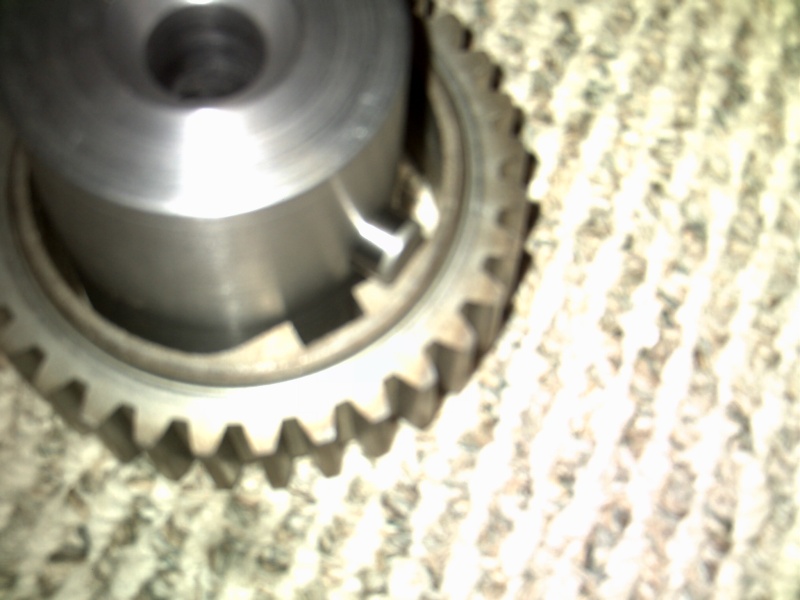

Here is the pictures of the hub thing that me and grandpa has designed, he finally made it but its going to need some minor adjustments.
here is the hub assembly
[img]Craftsman off road tractor - Page 7 Dscf0110[/img]
[img]Craftsman off road tractor - Page 7 Dscf0111[/img]
here is a test fit with the axle in the hub
[img]Craftsman off road tractor - Page 7 Dscf0112[/img]
[img]Craftsman off road tractor - Page 7 Dscf0113[/img]
here is the hub sitting on top of the bulk gear, it doesn't go down in all the way cause i need to drive the pins in alittle further.
[img]Craftsman off road tractor - Page 7 Dscf0114[/img]
[img]Craftsman off road tractor - Page 7 Dscf0115[/img],
well sometime were going to shave some metal off the hub cause it doesn't fit all the way down in the housing, but i don't want too much space or my axles will move left to right too much.

Im not seeing how itll hold the axle in? Youre using a one piece axle right?
Haha, now that you said something about it, i don't see a way it can be held in either. geek

no its a 3 piece but im welding the axles directly to the hub, with a really good welder too, thats how its going to stay in. cause the housing will keep the hub centered so it can't go any where, don't worry when i get her done ill show you how it will go in and stay.

well good news people, i have the axle welded so now its a one piece deal. Its strong too. My uncle made sure it had good penetration, he turned the welder up to voltage 3 which the highest is 4 and lowest is one. but welds look nice, but did have to buzz the welds just a hair, the welds were hitting the trans case, so now if i break the trans it will deffy be somthing other than the axle. well here is a picture,
so now this week im going to have it all put back together, but i have to clean the trans again, a dumb possum came in my shed and knocked it over on to the ground, oh man was i pissed about that. but luckily i didn't loose any parts Rolling Eyes

Motorhead45102: Thats cool- it looks strong . Welded the pulley to the motor? Redneck engineering at its finest..... I actually have a twin cylender that aparently from the factory with a steel "plug" holding the pulley on the engine- eventually i resorted to cutting the pulley off with a grinder to get the motor off the chassis ( w/o hurting the crank). Weirdest thing i ever saw. I took a pic of it years back to see if anyones ever herd of it:
https://i.servimg.com/u/f37/14/87/67/58/21869010.jpg
Same motor i want to put double carbs on- came off the kleen kut.
