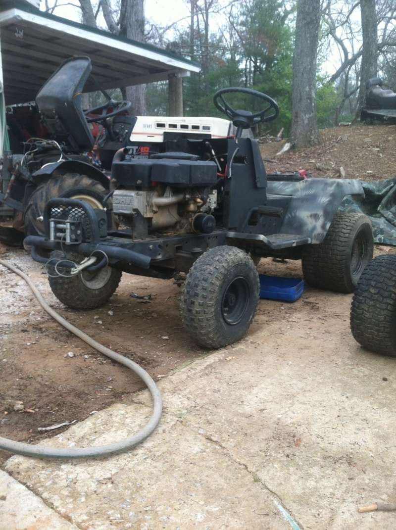

PostSubject: Re: LAWN RANGER craftsman mudmower   Tue Apr 14, 2015 10:28 am
sorry guys for not updateing this but the reason why is beacaue we have had the internet go and witch then we had to get a computer then that went out so im alsomst done with this rig but I got my briggs 16hp ohv motor on the craftsman I got 16 inch nobbys on the front there is 20x7x8 trail wolf atv tires on the rear I love them, I got the hole thing painted camo I got bumpers front and rear there is a atv rack on it and nerf bars the tranny is locked pulley swap done THIS TRACTOR IS DONE ALL IT NEEDS IS A BELT I drove it a coulpe of day ago it dose good for a motor that hasn't run in 2 years and a tractor that's been sitting in my yard for 3 years lol pics when my computer stops being a peace of crap

I like the skid plate. One on the transaxle would serve a better purpose though.
Posts : 546
Location : north carolina
PostSubject: Re: LAWN RANGER craftsman mudmower   Thu Apr 16, 2015 10:08 am
yeh Im going to I just done have anymore sheet medal and yeh the camo did come out well just for some reason those pics are as big as they can get

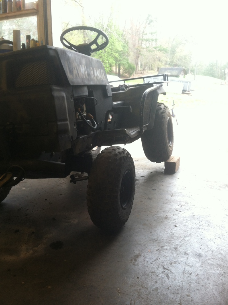

well I got my front bumper on and my winch
its on blocks so I could see how high and where to drill holes to bolt it on

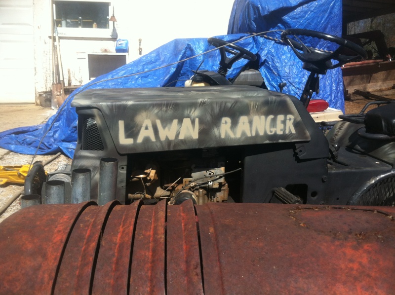

PostSubject: Re: LAWN RANGER craftsman mudmower   Wed May 27, 2015 11:47 am
here's a update I've been working hard on it and its really turning out good and I hope you guys like it
so I decided to make the camo a little better so I got some pine needle and sprayed over it to  make a pattern
here the name of the rig LAWN RANGER
and I also dropped the tranny its a peerless 920 5speed and took the hole thing apart to clean the grees out and run gear oil
ill have more updates as they come and hope you guys like what you see

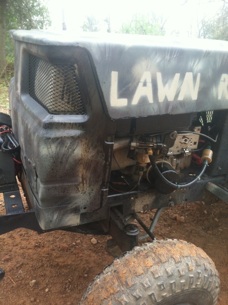

PostSubject: Re: LAWN RANGER craftsman mudmower   Wed Jul 08, 2015 11:32 am
here's the first time I drove it and it was awesome
and I drove it for a while and went over bumps and a big hill and all of a sudden it stated smoking and shut off, so idid some research and found out the pcv breather was letting oil into the carb like fearlessfront murray so I fixed that problem heres some pics
as you can see where the muffler shot all the oil out onto my hood
and sadly it only has 3 inches of flex so im thinking about make it get more flex is that a good idea
