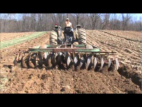

It digs up the ground and turns over the sod or packed dirt. Then later on you disc it when the grass has rotted away and when the ground is dry to break up the clumps, kinda like a tiller does.Plow idea help? Hqdefault
Then you plant, pick, and disc again next year(unless you have a drill planter, no need to disc next year, just plant). But I have something does more of this than turning.Plow idea help? 2012_october_digging_sweet_potatoes
