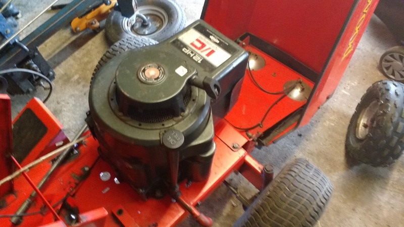

Some progress has been made over the past few days:
Removed the engine to clean the frame of old oil and dirt from previous oil leaks.
'86 Westwood T1200 - Page 9 Img_2013
'86 Westwood T1200 - Page 9 Img_2014
Also cleaned the bottom of the sump of the engine
'86 Westwood T1200 - Page 9 Img_2015
Engine reinstalled with M8 bolts, washers and lock nuts.
'86 Westwood T1200 - Page 9 Img_2016

Anyway, found time to get some work on the engine done today.
Stripped another 12hp carb that I had that was in better condition than the small 8hp one that's on the engine at the minute.
'86 Westwood T1200 - Page 9 Img_2024
Boiled the carb in water and vinegar for a couple of hours, rinsed it out, let it completely dry and assembled it again and got the Briggs running sweetly again. Also fitted a screw to the choke so that I have a manual choke at the carb when I'm pull starting it.
'86 Westwood T1200 - Page 9 Img_2025
I removed the straight pipe for now as it was a bit too loud especially in my garage. Screwed in a muffler that I've had laying around for a while.
'86 Westwood T1200 - Page 9 Img_2026
That's all for now Smile

'86 Westwood T1200 - Page 9 Img_2045
'86 Westwood T1200 - Page 9 Img_2044
When I was pulling a trailer I put the clutch in and nothing happened. It turned out that the clutch rod had broken off. I welded it back on at a slight angle to allow the clutch to move more and also installed a bigger clutch pulley. The clutch now bites a lot more and I don't think the belt slips anymore, I still have to test it under load.
I still want to make another belt retainer for the rear pulley as the belt comes off there now and again. Apart from that she's being really a useful workhorse pulling trailers etc. I'm also thinking of setting her up with 2 tanks to run on gas/kerosene. The flathead Briggs' run on kero very well when they're warm so a small tank for gas for starting would be needed. Let me know what you think! '86 Westwood T1200 - Page 9 2731072446
