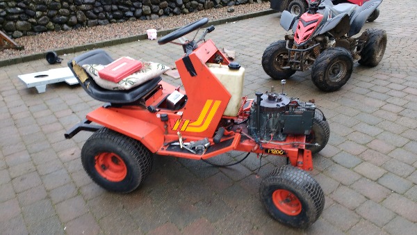

| Been a while so I thought I'd update. Pulled her out of the garage yesterday. Tried to get the flywheel off today, still no luck. It was soaking in WD40 for nearly a month. Tried a wee bit of heat too. Here she is, been sitting for near a month | |
