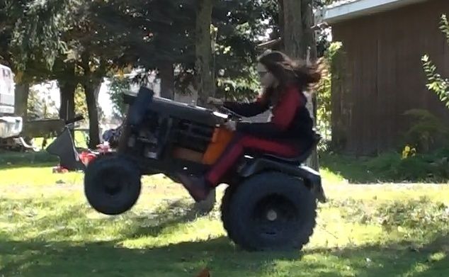

| So I pulled this out of the junkyard almost four months ago and built it up with a very minimal amount of money.It is a 1968 Simplicity Landlord with a 240000 series 10hp cast iron block engine with a starter generator electric start system. It is currently pulley swapped with 3 inch on the trans and a 6 1/2 inch on the engine. It tops out at around 30mph. This is it then. And now. " />" />

1997 Murray Veteran Member
Age : 25 Join date : 2013-11-13 Points : 5208 Posts : 1311 Location : NW USA
| Subject: Re: 1968 Simplicity Landlord Offroad October 27th 2015, 10:32 am | |
| wow, looks good, those simplicity's like to lift the front end off the ground for some reason did the atv tires come on it? | |

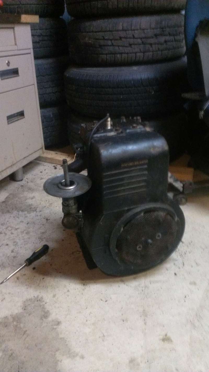

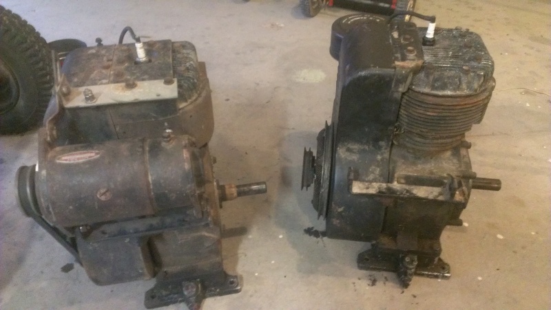

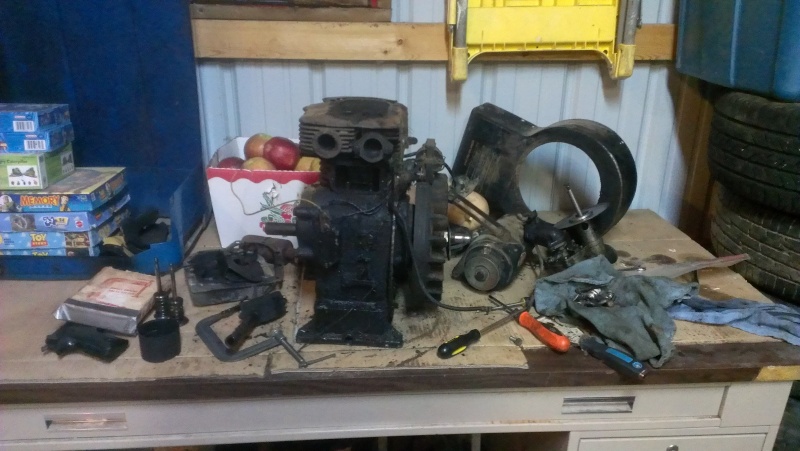

| Here is a better picture of what it really looks like. Alright so last weekend i bought a complete engine from the junk yard(that's kinda where i get all my stuff)and i had it apart in an hour and back up and running in two days. The engine is a syncro-balanced 12hp 300000 series cast iron block engine that now runs beautifully and loves gas. Apart Together got the 10hp out side by side comparison 10vs12 Sorry i forgot to take a picture after i was done but ill get one soon. | |

| Wow very nice. The 12hp should be a considerable difference, I think the dicplacement of the 12 is greater than the 10hp by like 3ci lol. | |

yea there's a pretty big difference in displacement. The displacement of the 10hp is 393cc (23.98ci)and the 12hp is 494cc (30.15ci). But so far the 12hp is performing ALOT better than the 10hp ever did. Now i just burn more gas but, thats all. | |

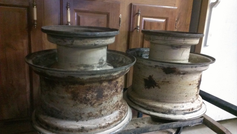

| so today i was riding my lawnmower around and my muffler fell right off. turns out my pipe broke but im thinking about doing a straight pipe exhaust with a spare pipe ive got sitting around anyways and the muffler came from a different lawnmower that ive got. also ive got some rims that i bought so i can get some new wider tires to mount on them for the front and back | |
