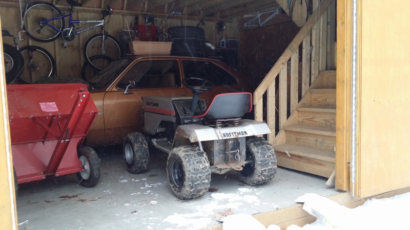

Here are some pictures of the tractor as received (May 30, 2015) from my neighbor Charlie for the price of moving it from his driveway:
Dustin's 1986 Craftsman Woods Tractor - Full Suspension, Electric Conversion 20150511
Dustin's 1986 Craftsman Woods Tractor - Full Suspension, Electric Conversion 20150512
Dustin's 1986 Craftsman Woods Tractor - Full Suspension, Electric Conversion 20150513
Dustin's 1986 Craftsman Woods Tractor - Full Suspension, Electric Conversion 20150514

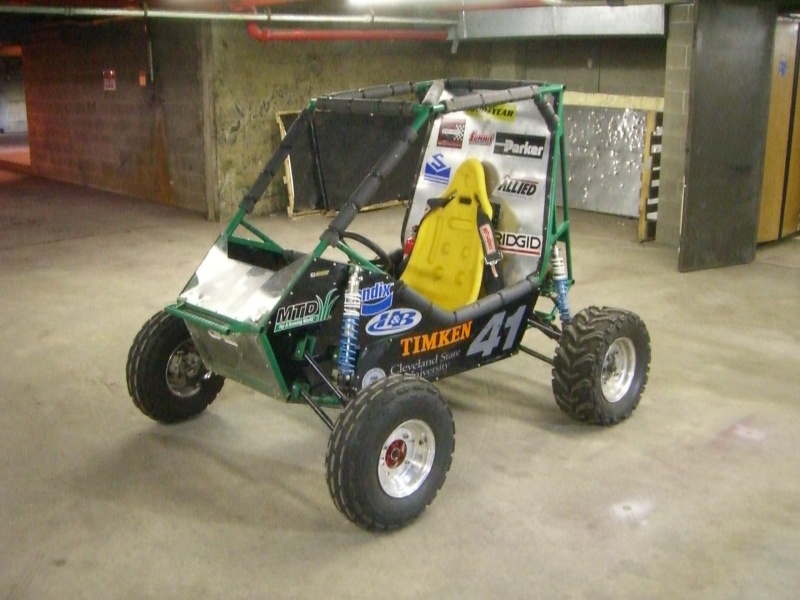

Here are some pictures of my first Baja SAE car (#41) that I built in March 2006 when I was in school for Mechanical Engineering. This car was completely spearheaded (I hate this business buzzword, but it is true) by me when I was a 2nd year student with the intent on beating the Senior's Team fancy new car at the competition, which I did by a few places with a team of a few other students that also have never built something like this. This car was built entirely of old "junk" parts from the shop except for new steel tubing for the frame/roll cage.
Dustin's 1986 Craftsman Woods Tractor - Full Suspension, Electric Conversion 2007-010
It sure did jump well with the unmodified horizontal shaft 10 HP Briggs OHV (the competition required engine) a little behind the rear axle.

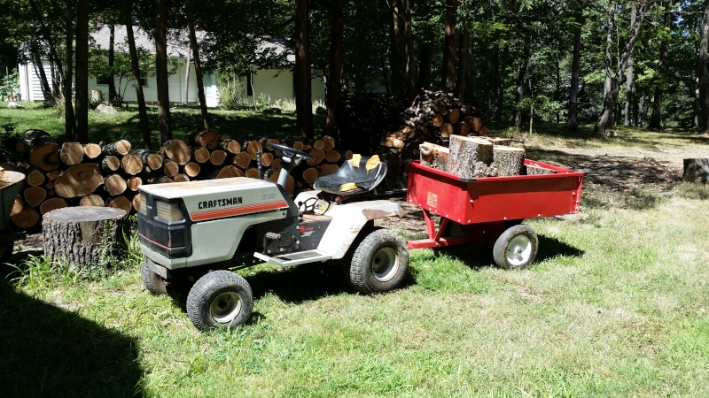

First day of usage moving logs from trees I just had cut down.
Dustin's 1986 Craftsman Woods Tractor - Full Suspension, Electric Conversion 20150813

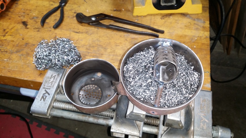

I figured it was time to build a muffler using the stainless pot scrubber method I read about somewhere. The pot scrubbers were not as open as I would like, but were the only kind available when I had my wife pick them up when she was at the store.
Dustin's 1986 Craftsman Woods Tractor - Full Suspension, Electric Conversion 20151011
The pot scrubbers ended up spreading out ok.
Dustin's 1986 Craftsman Woods Tractor - Full Suspension, Electric Conversion 20151012

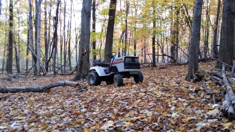

First deep woods romp to the back of my property. The few pictures I took were all a little blurry, sorry.
Dustin's 1986 Craftsman Woods Tractor - Full Suspension, Electric Conversion 20151016

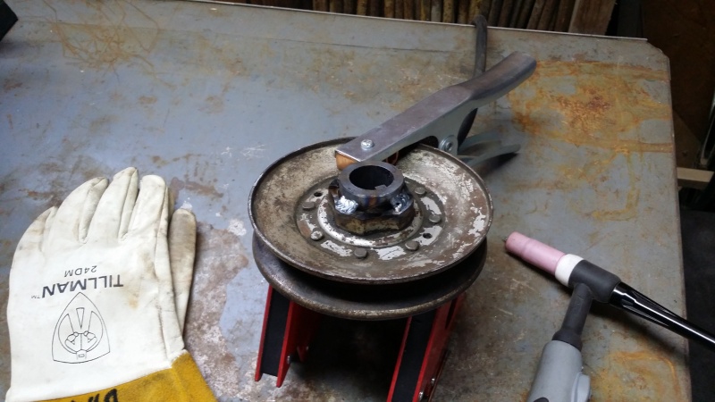

Time for the deck pulley to become the engine pulley and make this thing slightly quicker. This happened back in November 2015.
Yank the pulley off:
Dustin's 1986 Craftsman Woods Tractor - Full Suspension, Electric Conversion 20151110
Put on your PPE (personal protective equipment) when getting ready to do a large amount of grinding:
Dustin's 1986 Craftsman Woods Tractor - Full Suspension, Electric Conversion 20151113
Separate the old engine pulley from the deck pulley (soon to be new engine pulley):
Dustin's 1986 Craftsman Woods Tractor - Full Suspension, Electric Conversion 20151112
Carefully cut away the old engine pulley:
Dustin's 1986 Craftsman Woods Tractor - Full Suspension, Electric Conversion 20151114
Mount the center section of the engine pulley to a piece of threaded rod using nylon locking nuts to mostly center the center section due to the nylon locking nuts having a small rounded top part that fits in the mount hole. Chuck up the thing in a drill and smooth it out with the bench grinder until it fits nicely in the deck pulley bore:Dustin's 1986 Craftsman Woods Tractor - Full Suspension, Electric Conversion 20151115
Throw four small weld beads on there to keep the "new" pulley from falling off. It was not fully welded to facilitate easier removal in case I ever put something different on there:
Dustin's 1986 Craftsman Woods Tractor - Full Suspension, Electric Conversion 20151116

Here are some current pictures of the Craftsman tractor. We have not had much snow here in Ohio this winter. So when we got a bit of a snow storm on March 14th, I had to get the tractor out for it's first test in the snow (which I should have done months ago). It did rather well with the OEM Yamaha Raptor 90 wheels and tires with open diff. Bonus points for knowing what the orange 2-door hatchback is tucked behind the tractor!
Dustin's 1986 Craftsman Woods Tractor - Full Suspension, Electric Conversion 20170310
Dustin's 1986 Craftsman Woods Tractor - Full Suspension, Electric Conversion 20170313
Dustin's 1986 Craftsman Woods Tractor - Full Suspension, Electric Conversion 20170311
Dustin's 1986 Craftsman Woods Tractor - Full Suspension, Electric Conversion 20170312
The loudness of the internal combustion engine out in the peaceful snow, has really kicked me into gear to get this thing converted to electric. I am currently testing and building my battery pack and pretty much know the motor I will use.
Thanks for the tip about the making a quieter muffler @prancstaman, but my days of fiddling with engines are numbered. The tractor actually has a small additional muffler on it currently and it is not too offensively loud.
Current completed modifications to hopefully cover before getting into the electrification: replacing the Briggs starter's melted brush holder with one from a Tecumseh starter, the hubs I used to adapt the ATV wheels and tires, LED lights that fit in the stock sockets and housings, rehabilitation of the scavenged red trimmed Craftsman seat, and switching the starter battery to using RC car lithium polymer (lipo) batteries!

That there orange hatch looks to either be a Yugo, Mk1 Golf, or a Mk1 Fiesta.
No dice, good guesses but all front wheel drive, I stick to rear wheel drive only! I will hold out the suspense a little longer before I let the cat out of the proverbial bag.

chevy chevette

pinto?

I agree with Lawren.  Maybe a 76 chevette?

yeah i just looked on google. i dont think its a pinto... definitely chevy chevette

Chevette or possibly an AMC Gremlin?
