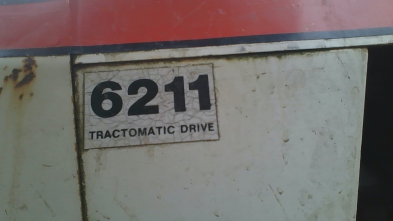

Wow, lots of competition this year. I'll have to work hard with all the fancy plans everyone has. Anyways, this is my entry. It is a 1984 simplicity 6211 (last two numbers are the tractor hp, and the 62 means simplicity made 62 different attachments that this tractor would accept) It has a 3 speed cast iron transaxle with an extremely low first gear, it goes about half a mile an hour stock at full throttle, its slow. In 3rd its about 10 miles an hour. 2nd is about 5 mph. I'm starting with a "running" tractor, but I'm replacing the stock 11hp briggs with a 19.5 hp briggs oppy, which I have a larger than stock adjustable carb for (the one the motor had on it was the 4 screw non-adjustable one) so I'm going to call it 20hp. It is a 46 ci motor. I am going to try to gear it up to do about 40 top end to keep up with the quads, and I'm gong to build front leaf spring suspention like redlinemotorsports did, and I'm going to replace the stock steering box with a rack and pinion from the POS "go cart" sitting next to the tractor. I'm going to build a PTO powered winch with a foote gearbox of a rer I have, and a rear rack is planned. The rear fenders are narrow, so I plan to put on craftsman fenders or make custom ones, and maybe have the ability to hold two people. I am using the 25" bearclaw tires on the back of the craftsman you can see in the background, and also 21" front tires. Dual exhaust and gas pedal, and I have to swap the clutch to the other side of the tractor to put the gas there, and I will upgrade with go-cart breaks. I may end up doing direct steering and handlebars and mount the throttle up there. Good luck to all the contestants!
