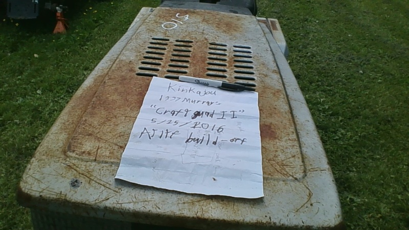

The latest lame build from the garage of 1997 murray.... The Craft Quad II. It will be a general romper/mudder/ trail machine. I hope to keep up with quads, so the goal is 35 to 40 mph. It will have a 18hp briggs oppy for the moment, and I will have to figure out a way to change the engine pulley so I can get to that speed, because the engine pulley is bolted to the flywheel. I may have to make my own pulley on the lathe. I will give you guys a list of mods here.
-front bumper
-rear rack/bumper
-front winch
-lift front axle 2"
-lock rear end
-maybe 25" front tires
-definitely 22" front tires
-foot throttle
-750cca battery
-maybe shaved heads by .030"
-custom exhaust, need ideas.
-maybe side bars to keep stickers off my legs
-upgraded lighting
-25" kenda bearclaw rear tires
-MAYBE atv carb so as to avoid oppy flooding/poor running with non adjusible main jet carb.
-snorkel, as high as possible under the hood, so it doesn't stick out and look funny.
-DIESEL yanmar 8hp clone, 3" exhaust
-paint, most likely red and black
Here are some more pics.
