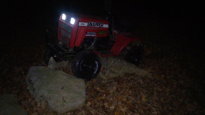

Threw the trans back in, put the skidplate on, and put the battery back in(stole it for the parts murray). She started right up so I romped her a bit. Luckily I didnt break the steering hub this time, lol. Unfortunately, the input bearing and gear is no quieter than the last ones. Whatcha gonna do I guess.
Took some pics when i stuck it on some rocks
Craftsman GT3000 "MUTT" Part I - Page 13 23335510
Craftsman GT3000 "MUTT" Part I - Page 13 23318710
Craftsman GT3000 "MUTT" Part I - Page 13 23360910
Craftsman GT3000 "MUTT" Part I - Page 13 23364810

Good to see MUTT tearing it up again. Nice work Rich!

Looks good, nice to see MUTT out in the field again!

Yeah they do!
Some kool edits done by my bud @ConfederaSears
Craftsman GT3000 "MUTT" Part I - Page 13 23601910
Craftsman GT3000 "MUTT" Part I - Page 13 23584910
Craftsman GT3000 "MUTT" Part I - Page 13 23574410
Craftsman GT3000 "MUTT" Part I - Page 13 23574210
Craftsman GT3000 "MUTT" Part I - Page 13 23549710
Craftsman GT3000 "MUTT" Part I - Page 13 23548210
(Original pic)
