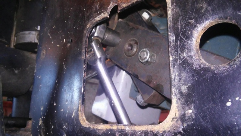

New clutch linkage mocked up. Used my best ball joints for this. Woulda used hiems but I like the offset of these, plus fine thread is good to have. Less likely to come loose. I have it welded now, gonna pretty it up with the bench grinder. 3/32" 6013 is not nice for welding or tacking. Actually gotta have the welder on 60 to be able to control the puddle. I'll paint it and get another pic later.
