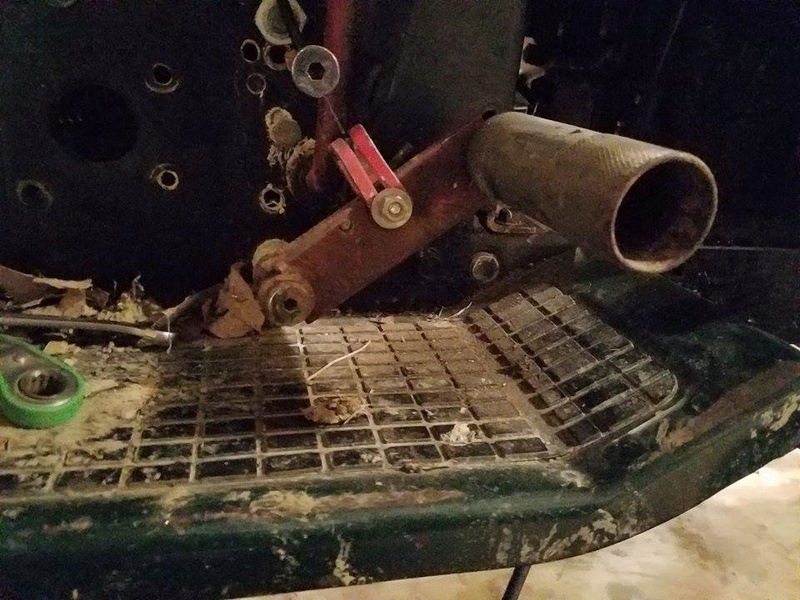

| Subject: Re: Craftsman GT3000 "MUTT" Part I December 3rd 2016, 12:05 pm | |
| Found out last night that the booster fan only works on the engines with metal cooling fans, and I don't think the 40ci horizontal flywheel will work with a 42ci vertical engine . Oh well, the one I have works just fine. Anyways I was going through my wiring last night looking for bad connections and found that there wasnt any, the battery is dead. Although I cant blame it, that thing is a year younger than me (i'm 14)and has been through a car crash and a few tractors, It doesnt owe anybody anything. Also when I was doing my steering I put a foot peg on the gas pedal, tightened up the gas pedal cable (actual full throttle now ), moved the cable stop for the brake (doesnt lock down anymore but braking power is good). Don't know what I'm going to do for a battery, of the two I have one has a hole punched in the side of it and leaks and the other one is like 325 cranking amps new, not near enough to spin over this thing. I dont have any dollars for a new one either... | |
MatthewD Veteran Member
Age : 22 Join date : 2014-11-16 Points : 5537 Posts : 1993 Location : Northern Ireland
| Subject: Re: Craftsman GT3000 "MUTT" Part I December 3rd 2016, 12:09 pm | |
| Nice foot throttle. Are you still running the governor? You could just pull start that oppy everytime Be hard on the arms lol | |

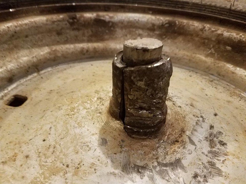

| Subject: Re: Craftsman GT3000 "MUTT" Part I December 17th 2016, 5:02 pm | |
| So, in the ~2 weeks I've had to mess with the rim, this is as far as I've got. Cracked it in another place and bent the rim part it's welded into (huib is now crooked lol). Whoopdefrickindo. I think I'm gonna mickey mouse this back together the best I can and buy a pair of used atv rims that I can make or buy hubs for. | |
Doug Site Owner
Age : 28 Join date : 2012-12-24 Points : 7553 Posts : 3035 Location : Lebanon County, PA
| Subject: Re: Craftsman GT3000 "MUTT" Part I December 17th 2016, 5:24 pm | |
| Should be ok, not like its a speed build. Weld it, sleeve it, weld it up again. Head Forum Administrator ** Chat Moderator ** Facebook Page AdminATLTF Facebook Page ** Chatbox ** How To Upload Pictures
