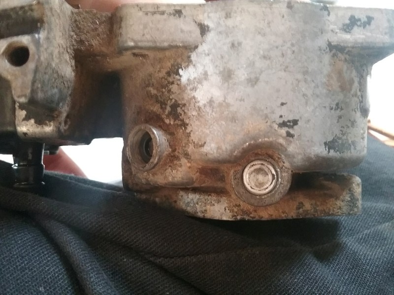

Put a welch plug in, there wasnt one before
Made a new choke linkage. This older carb is a bit different than a typical 3 screw, a bit smaller i think, and the port you'd drill for an external fuel pump isn't there. The old linkage was a bit long and made the arm go too far. It was usable but i didnt like it.

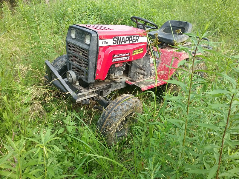

But anyways, a pic of her out and about...
