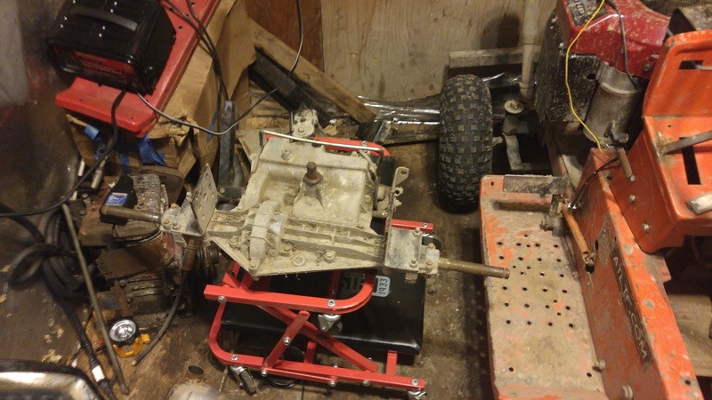

| wellllll.... all of the 800series transaxle i have are bad. they all grenaded the output pinion needle bearings.. so, for now i just shoved a brass bushing in there. lets hope for the best, but i remember that when i doc locked my trans it had that slop, so if it lasts another 5 months ill be happy. new traanny, nastyness. i reused my clean gears and cleaned up the case halves. yeah there should be needle bearings between that shaft en the gear.. all cleaned up, ready to be put back in the tractor. i am getting a mst205 to remplace this trans. going to have to doc lock it, i give up on the 800s, they are beefier on paper but in reality i keep finding broken ones.. | |

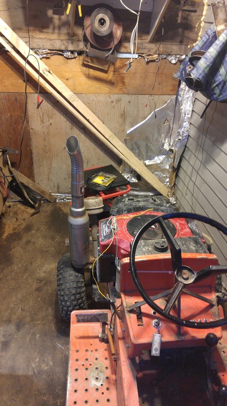

| got the mst 205 ! got the parts i needed to do a proper exhaust.. stack ! The new MST, once i doc lock it its going in ! today's mess Shop dog Probably going for a small short stack like this. i like the stack better than the ''sideways'' stack.. -wire up the engine, dual diode setup DONE but redoing it with proper connectors -make up an exhaust, 2 to 1, with atv mufller -relocate gas tank where ? -battery boost system, anderson plug ? -front bumper W front towhooks -make the hood fit around the engine.. -headlights, nilights dual flood.. -add a 3rd battery ? -buy and mount new rear tires -rear mud flaps -front fenders -swap an even bigger engine pulley or smaller rear ? -belly pan, keep the sticks out of my belt.. -Swap in MST205 after i doc lock it. -voltage regulator ? | |
Age : 21 Join date : 2016-10-29 Points : 6578 Posts : 3613 Location : Lewisburg, KY
| Subject: Re: The 18hp Yard-Man Trailmower July 17th 2017, 3:09 am | |
| Lookin good! I'm not much of a stack person, anymore. Don't want hot stuff puncturing me if I roll my tractor lol. You finally gonna do axle supports with this mst? lol And the more speed the better | |

- Lookin good! I'm not much of a stack person, anymore. Don't want hot stuff puncturing me if I roll my tractor lol. You finally gonna do axle supports with this mst? lol
And the more speed the better yeah i dunno i really like the look of the stack, it would be shorter than in the pic tho. and yeah eventually i want to make some axle supports but before that ill reinforce the frame so its no a priority.. | |

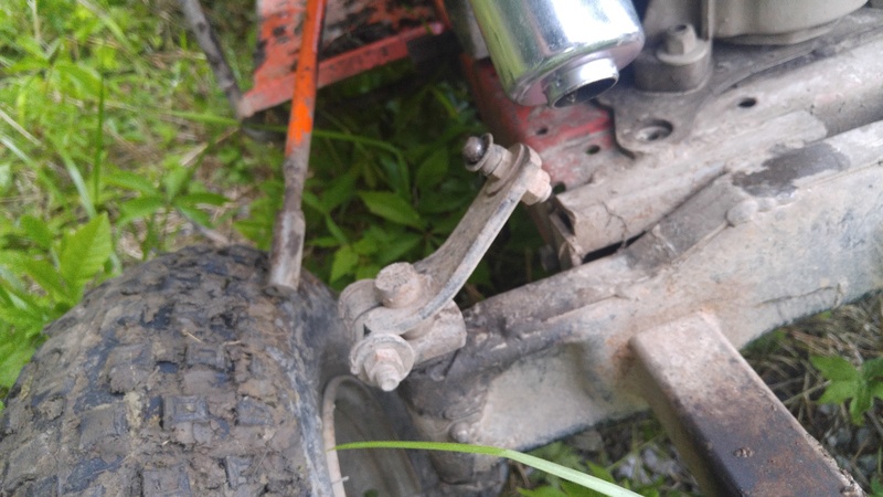

- HA, I didn't realize that was you over in the Garage. Careful with those ruts! @RichieRichOverdrive and @AllisKidD21 broke steering too.
Wonder if you can upgrade that to a heim? yeah was me ! lol gotta have a weak point at least its not the steering gears thats broken ! yeah im going to make 2 new beefy tie rods with proper heim joints. | |

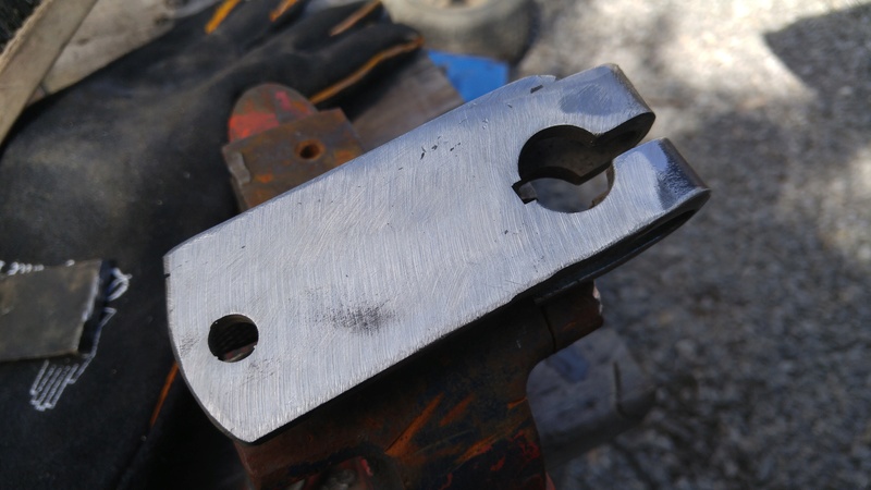

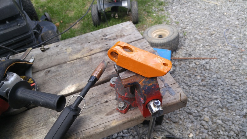

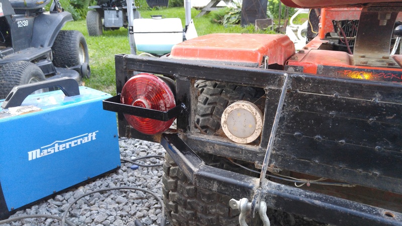

| today i fixed my bed steering arm and the broken tiw rod. i made a new reinforced steering arm out of 1/4'' flat stock used an original piece with some reinforcement FINNNALLLLLLY made to tailights guards, after breking 4 or 5 lenses.. oh ! and immediatly after i fixed the steering. i went for a test drive, tried to do donuts, tyres hooked up and threw me off... destroyed the steering wheel, so i remplaced it.. the new steering.. actually the original one ! still have alot to do !! to do: -wire up the engine, dual diode setup DONE but redoing it with proper connectors -make up an exhaust, 2 to 1, with atv mufller -battery boost system, anderson plug ? -front bumper W front towhooks -make the hood fit around the engine.. -headlights, nilights dual flood.. -add a 3rd battery ? -buy and mount new rear tires -rear mud flaps -front fenders -swap an even bigger engine pulley or smaller rear ? -belly pan, keep the sticks out of my belt.. -Swap in MST205 after i doc lock it. -voltage regulator ? -steering stops | |
Age : 25 Join date : 2016-07-10 Points : 8371 Posts : 5190 Location : Ontario Canada
| Subject: Re: The 18hp Yard-Man Trailmower August 6th 2017, 10:26 pm | |
| That steering arm looks good! Shouldn't break any time soon. Looks like that old steering wheel is pretty tweaked hahaha. "This'll either wake you up or put you to sleep forever!"- Red Green "Whatever you do you should do right, even if it's something wrong." - Hank Hill - MTD Off-Road Build - Ford LT 110 Off-Road Build - Craftsman GT 6000 Off-Road Build - Sears LT11 Rat Rod Build *2019 Build-Off Winner!* Garden Tractor Collection: Allis B-110 x2, 710, 716, & 410 - Wheel Horse 655, 953 & 500 Special - Case 444 - Bolens Versamatic, G10 & 1668 Diesel Swapped - Cub 106, 124 & 1000/149 Frankentractor - Ford 120, LGT 125 & 145 - White 1650 Yard Boss - Moto Mower 710-100 | |
