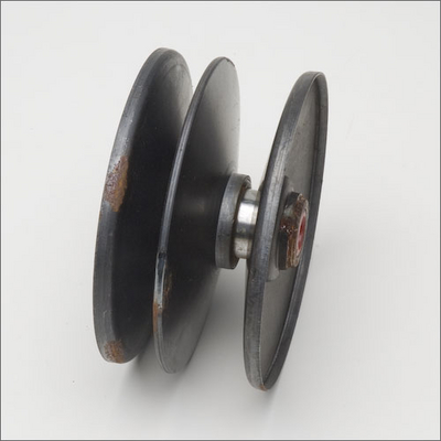

i have an idea but i dont know if it would work. i would like to replace the variable speed pully
example
My first post  - Page 2 917-0810
and replace it with two normal pullys. that i know will work but, dose that mean that instead of just the drive and transaxle pullys  i will have two more pullys to swap and gear even faster and still keep the power. i dont know if im making sense im kinda confusing myself. will it make any diference if i had four pullys to swap instead of just two is what i think im asking. lol My first post  - Page 2 2429134702 My first post  - Page 2 2429134702 My first post  - Page 2 2429134702

You could use those pulleys for a swap instead of trans or engine pulley swap, but you will need to make the pivot solid and fab up a new clutch.
Yes, and no. While doing that would give you the equivalent of a jackshaft and therefore offer a another point of gearing, you will ultimately be able to go no faster or have no more power, than if you just had a standard pulley setup. Speed and torque are finite. You cannot add more than you have available to you.
To make matters arguably worse, by doing this on an MTD, you lose ALL semblance of multiple "gears". You'll have afixed ratio. Picture putting your car in 5th gear, and trying to take off from a standstill. Ugly. If you're going to eliminate the variator, you're honestly best to replace that single speed trans with a multi-gear unit.

Keep the variable speed pulley. They can be a PITA to get the belt sizes just right on a pulley swap, but they are a good set up. I plan on using that on the slingshot build. It is basically a manually adjusted CVT and a damn cheap way to do it. You need to keep the needle bearings clean and greased on the slider. Rust on the pulleys will eat up belts pretty quick too.
