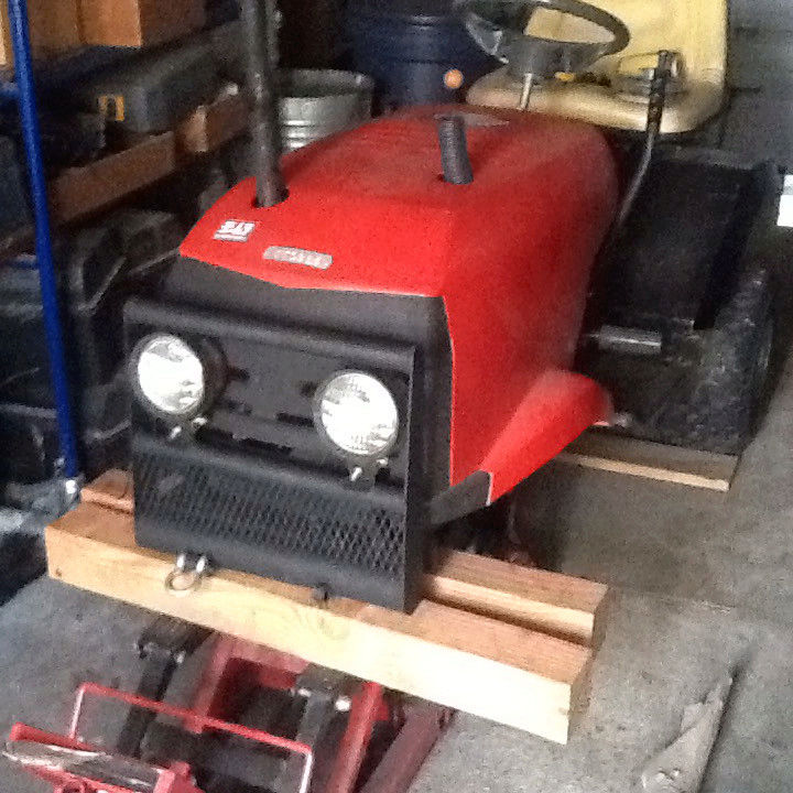

| Did I forget to post pictures of th sick bumper that I made? It's really heavy duty and it looks great in my opinion. I need to figure out how to wire the lights now. Also I found a manual boat trailer winch at the scrapyard for 5 bucks should I mount it on the front? Mod Edit: (Mightyraze) Undid the App thurmbnail to large pix. | |

Age : 49 Join date : 2016-09-06 Points : 15032 Posts : 10618 Location : Oklahoma
muckmudd Established Member
Age : 21 Join date : 2017-07-11 Points : 3345 Posts : 825 Location : In the shop
| Subject: Re: Husqvarna LT 130 MUD mower December 21st 2017, 7:22 pm | |
| - mightyraze wrote:
- Pretty sick looking bumper.
thanks! have you ever put a manual winch on a mower. | |
