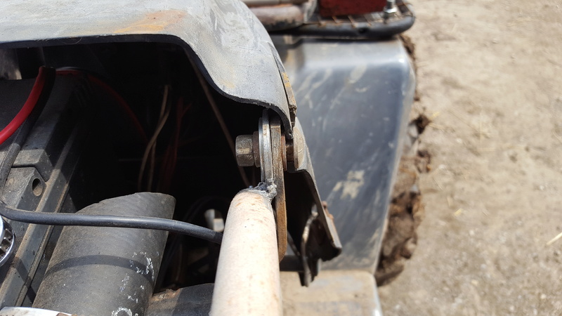

So today I did my grille support and hood pins. Not sure if I've mentioned it but I've been wanting to do those things for a bit, haha.
For the supports I just found some nice small tubing, cut it to length, and pounded the ends flat.
Craftsman GT 6000 Build - Page 17 20180519
Craftsman GT 6000 Build - Page 17 20180516
3/8" bolts welded in the grille tubes and holes drilled in the support bars for them to slide over.
Craftsman GT 6000 Build - Page 17 20180517
Then I just welded washers on the other ends and bolted them to the dash brackets.
Craftsman GT 6000 Build - Page 17 20180518
Both bolted up!
Craftsman GT 6000 Build - Page 17 20180521
Looks fairly nice woth a bit of flat black on it.
Craftsman GT 6000 Build - Page 17 20180522
Then just wing nuts to hold the hood down.
Craftsman GT 6000 Build - Page 17 20180520
I like it! Nice to have the hood held down for once, haha. Grille seems a lot stronger too, you can push the tractor by the grille and it seems fine. I'll assume that means it's good, haha. Let me know what ya think!
