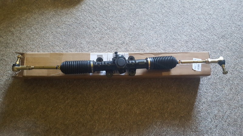

Huh, got a package in the mail today:
Craftsman GT 6000 Build - Page 19 20180622
Could it be for the GT?
Craftsman GT 6000 Build - Page 19 20180623
Hahaha, yep. My rack and pinion showed up! Thinking about just extending my right hand steering arm and only running one end off the rack, like they do on golf carts. That way I don't have to shorten anything.
Progress to come soon hopefully!

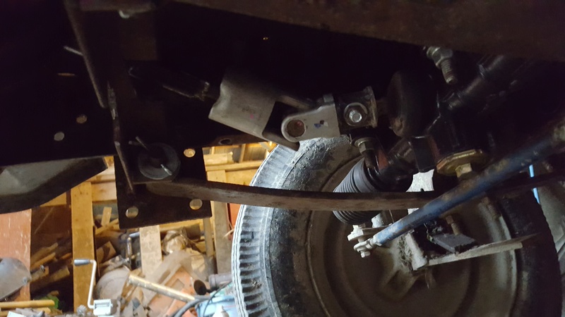

Made some progress on the rack and pinion swap yesterday:
Craftsman GT 6000 Build - Page 19 20180624
Made some angle steel mounts to be welded to the axle:
Craftsman GT 6000 Build - Page 19 20180625
Craftsman GT 6000 Build - Page 19 20180626
A bit of bracing, don't want the mounts breaking off
Craftsman GT 6000 Build - Page 19 20180627
The tip in the gun of the welder was sticking real bad here, so please excuse the bad welds, haha.
All mounted up and the rod end hooked to a steering arm I welded on to the original spindle:
Craftsman GT 6000 Build - Page 19 20180628
That's as far as I got, I just have to rig up a steering shaft now. That may require a bit of thinking, but hopefully I'll get to that soon. Let me know what ya think!

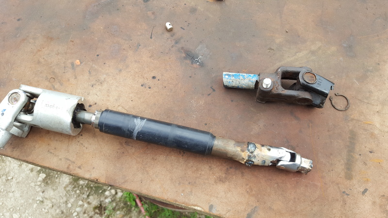

Finished the rack setup today!!
Got a couple different U-joints here to work with:
Craftsman GT 6000 Build - Page 19 20180630
I got the factory steering gears and shaft out:
Craftsman GT 6000 Build - Page 19 20180631
Had to shorten the steering shaft a fair bit to get it to work with this new setup:
Craftsman GT 6000 Build - Page 19 20180632
Craftsman GT 6000 Build - Page 19 20180633
Made a nice little lower steering shaft support bushing, as I didn't wanna just rely on the upper one.

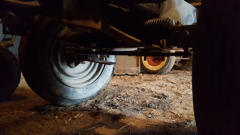

Works great! Ratio is just a hair lower, no play, and no bumpsteer!
Craftsman GT 6000 Build - Page 19 20180641
Craftsman GT 6000 Build - Page 19 20180643
Craftsman GT 6000 Build - Page 19 20180642
Frame touches the boot at full flex but not the actual rod:
Craftsman GT 6000 Build - Page 19 20180644
Might add a couple bumpstops anyways just to be safe. I have a couple rubber things I could use that would work quite well.
But yeah, definitely loving the new setup.
Craftsman GT 6000 Build - Page 19 20180645
