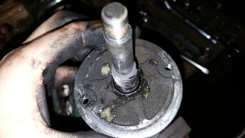

So I did a little digging tonight.
Craftsman GT 6000 Build - Page 4 20171227
Took my blower shroud off just to take a look at things, could use the usual cleaning of the cooling fins. But I wiggled the starter gear assembly and it has a ton of side to side play. Whoops, the upper bushing is trashed.
Craftsman GT 6000 Build - Page 4 20171228
Craftsman GT 6000 Build - Page 4 20171229
You can see the gap. Kinda sucks but I decided to just swap the whole upper plate from the other starter onto this one, should be no problem.
Got the rest of the starter waiting to be put back together once I get the other bushing plate.
Craftsman GT 6000 Build - Page 4 20171230
The inside of the starter body could really use a blowing out, so I'll do that before re-assembly.
Craftsman GT 6000 Build - Page 4 20171231
Hopefully I can get the parts all swapped out and get the starter working again soon!
