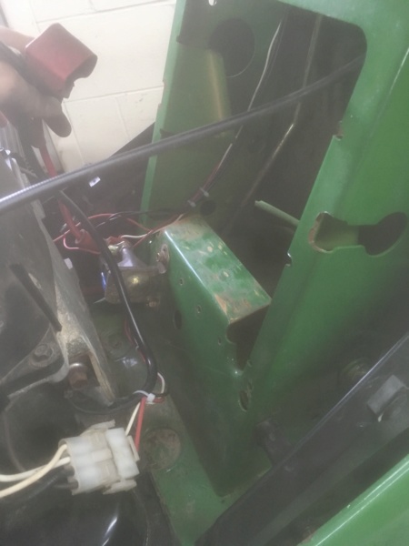

I ripped out this mess today...
I figured out the regulator and the kill wire on the motor.  I need to find a wiring diagram for the key switch and wiring everything back up should be cake.  It was interesting to see that John Deere didn't use any fuses anywhere but three relays of course which are coming out.  I want less things to fail.  I'm a little unsure about wiring the hour meter back up.  I hope it just needs 12 volts when the tractor is running but I thought it used to display the hours all the time but I'm unsure.

PostSubject: Re: 1999 John Deere LT160    Fri Jun 29, 2018 9:01 pm
Well I got my wiring done today.  Everything worked on the first try.  I'm so glad all of the safety switches and relays are gone.  The hour meter still works!
The old wiring used the AC leads from the coil for something in addition to going to the regulator and charging the battery.  I took the extra AC wires out.  Does anybody have any idea what they could have been used for?
I don't have my lights hooked up yet but I left myself a pigtail for them.  I now have a 20 amp main fuse too (thank you parts craftsman).  JD had a fusable link instead.

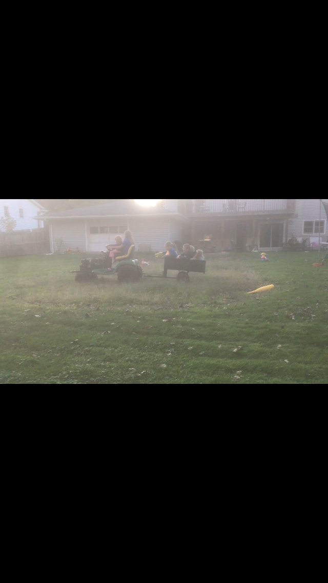

Well I took the John Deere over to my friend's house to haul some dirt because his mower kept getting stuck in the woods.  Then all these kids showed up.  There were too many smiles to count.

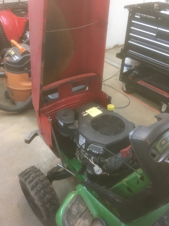

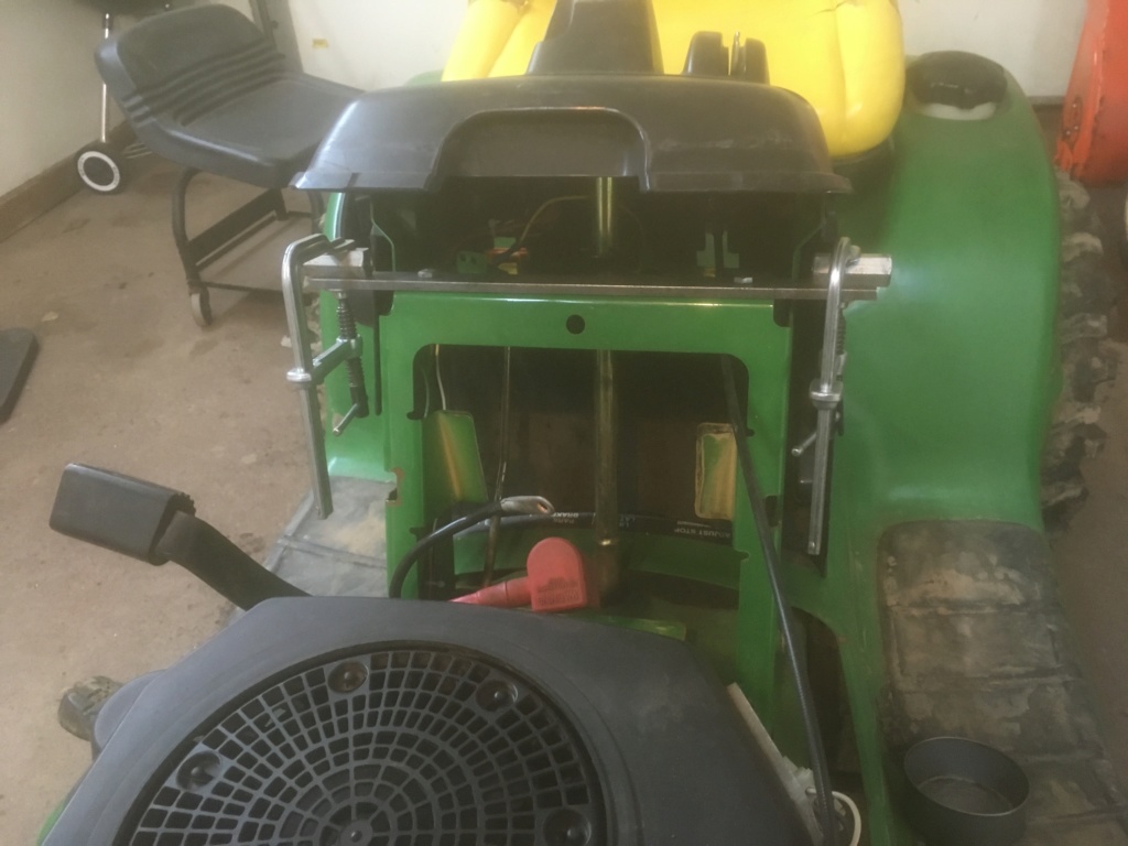

This tractor has waited long enough.  It's finally getting a hood.  My plan for this tractor is to leave it at my sister's for a while so my niece and nephew can drive it along with their 110cc kids atv.  There is a short list of things I want to do to it first:
-mount hood
-paint hood and front bumper
-install LED tail lights and headlights
First thing was to address the cracks in the mounting area of the hood by reinforcing it with 1/8"x1" flat stock.
then using 45 degree bends I made a couple of struts to support the grille.
They support the grille really nicely and I like this flip up hood design.
I'm looking forward to seeing this painted green.
I'm going to drill a couple of holes in the hood for 1/2-13 thumbscrews.  I'm going to weld these couplers to this piece of flatstock I bolted to the dash to support the other end of the hood.

Well the support I made for the dash side of the hood came out really nice.
The cat is just amazed that the bolts go right in without fighting it.
