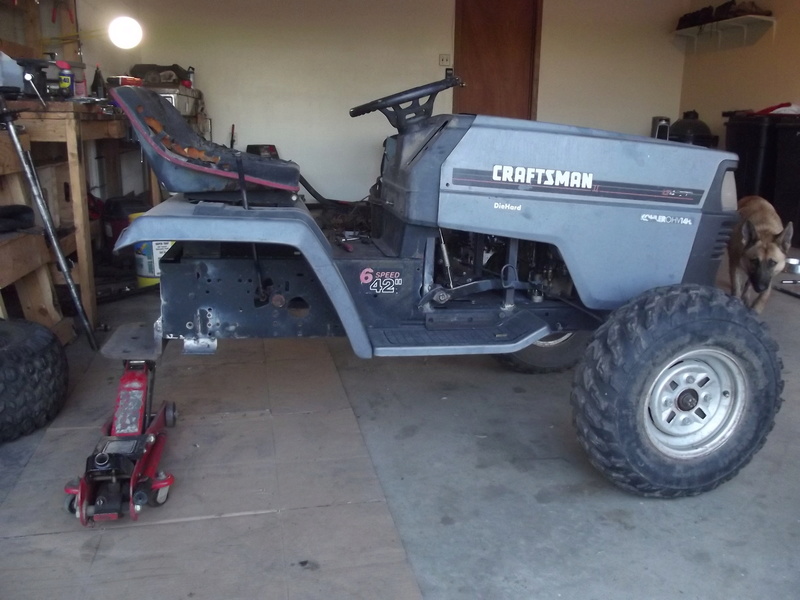

This is a build that i have been working on for a couple months but have been doing small things once at a time .
Currently it has a 19.5 hp Briggs and Stratton opposed twin (governor removed fully) , with slight head work and porting .
Fully re-enforced frame with 1 inch steel tube down the entire frame and re-built console to make a stronger steering system, using a murray pan frame steering pinion and gear .
The front end is made out of 3/16" steel square tube with front wheel assemblies home made crossing golf carts spindles with atv wheel assemblies with drum brakes to hopefully have functional front braking for better uphill and down hill stopping . I hope to put a 820 peerless in it with some type of tires that have at least 1 inch of aggressive tread.

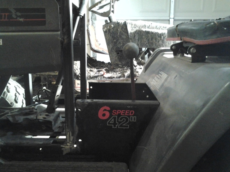

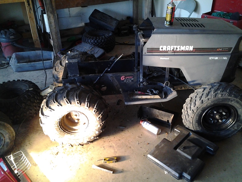

Did some work on it today and i had done a few odds and ends over the last couple of weeks .Put the 930 in it and it has a few shifting linkage problems
This is in 6th gear position , and halfway down the tranny case.( trans shifter plate is in 6th gear position)1993 Craftsman LT4000 heavy mud build. Img_2094
Different angle of same thing.1993 Craftsman LT4000 heavy mud build. Img_2097
This is in reverse position .1993 Craftsman LT4000 heavy mud build. Img_2100

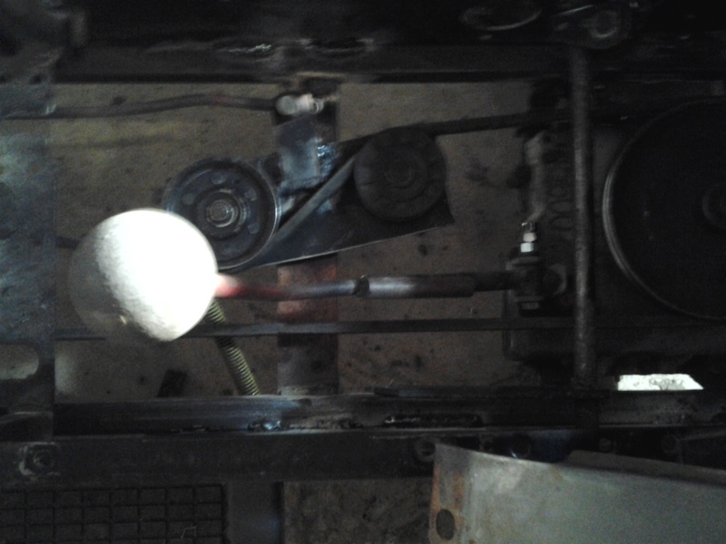

Also put in a clutch, not fully hooked up but pretty close.1993 Craftsman LT4000 heavy mud build. Img_2095
Stole the mud lites from the murray cause its not going to need them for awhile1993 Craftsman LT4000 heavy mud build. Img_2098

That is one heavy duty clutch you built there. Looks good!

She looks mean with those mudlights! Clutch should hold up nice. Hardest thing about them is getting the pivot right. It's a bit hard to design them to keep the slop out of them for the long term.

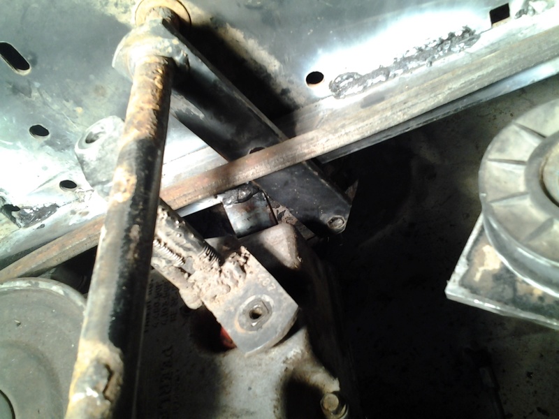

I made it so it has a replaceable pivot plate thats roughly 2.5 by 2.5 inch plate that makes full contact so theres not any slop , i just put some grease on the plates so it shouldn't wear much.
Got the shifter figured out, and i like this style way better because its simple to work on and out of the way so branches and brush wouln't catch it like it would normally being on the fender.1993 Craftsman LT4000 heavy mud build. Img_2101
