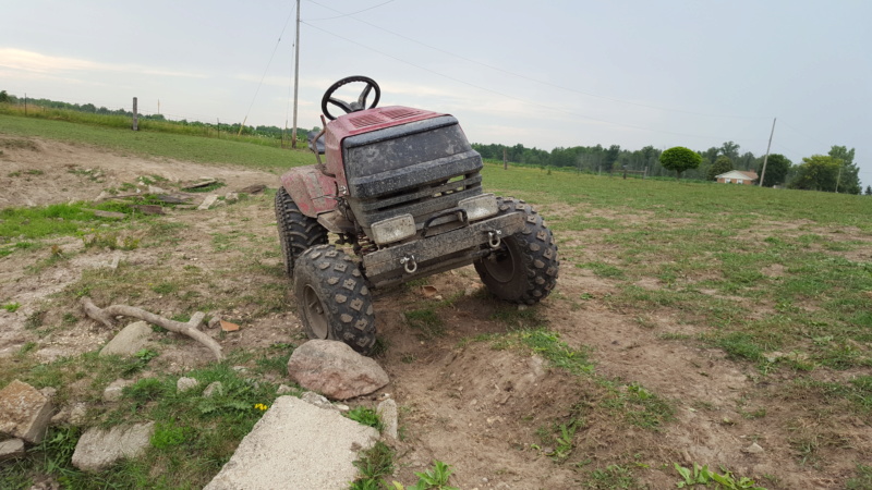

Well since I did the Y-link setup I never actually tuned up the radius arms, adjusting the length and caster angle, etc,  so I figured I'd tackle that.
MTD off-road build (Mobile Terrain Dominator) "2" - Page 12 20180731
After adjusting the upper and lower links on the right hand side I got a solid measurment from the frame mount to the front of the axle:
MTD off-road build (Mobile Terrain Dominator) "2" - Page 12 20180732
MTD off-road build (Mobile Terrain Dominator) "2" - Page 12 20180733
22" on either side give or take an 1/8", that's pretty good by me! I did a bunch of romping around and the oil temp gauge got up to 180° F which seemed pretty good, considering it was just over 80° F outside today. Nice to know she's not getting too hot after a good run.
MTD off-road build (Mobile Terrain Dominator) "2" - Page 12 20180734
Definitely happy with how she's performing now.

Skidplate looks good! Cant really trust that cast aluminium, haha
