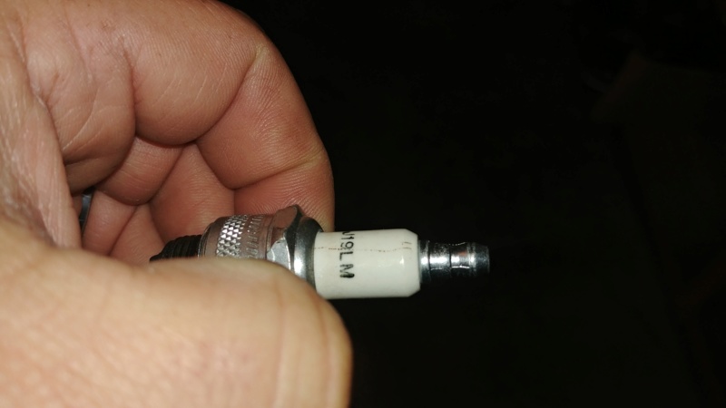

Here is that offending spark plug.
Also, found a set of older ribbed plugs that looked new. Kal fired up without hesitation, I have not gotten a chance to rev or ride at this point.

PostSubject: Re: Mightyraze's Kal-El [2018 Build-Off Entry]    Sun Aug 12, 2018 6:27 pm
OK...
What a cluster....
1st, that busted spark plug from little over a week ago.
2nd, I was actually running out of gas (pulling another @alliskidd21) it was sucking in a lot of air bubbles.
3rd, checked the spark.  One side was weak and the other side was non existent.  I swapped the plugs and those conditions followed those plugs. (They were the old plugs from the engine that I did not toss).  Pulled the plugs from my spare engine.  I was shocked they were not black, but clean with a little white.  They have been in that engine for 3 years and running regular up till last year.  Checked spark and it was bright blue.  Phew! Not the coil!  I  fired it up and it was back to being perky again.  It will lean me back in the seat again on accelleration.  I just need to adjust that idle jet a little.  It is 2 turns out.  I'd like to take it back down to 1.25-1.5 turns and see what happens.
So in short my engine is back in order in the power dept.  Now I can work on some things like maybe some steering slop.
