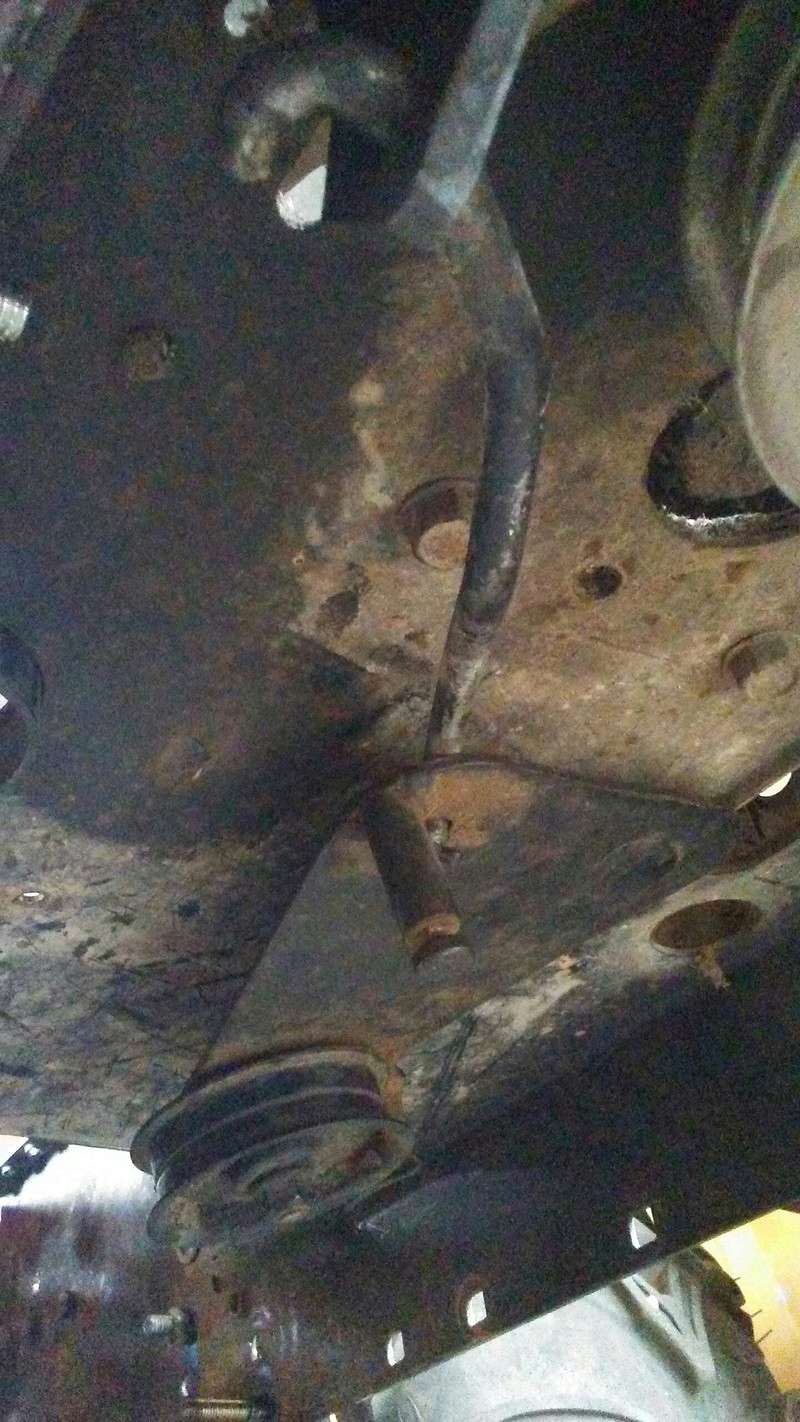

| Didn't trim the fenders today, just didn't feel like using the grinder. Painted the engine shroud: Just kinda cleans it up. Dual pulley clutch is working! No the second pulley isn't on yet, lol. But here's the flimsy clutch setup on the original: Don't want to trust that. Oh btw, here's a gorgeous sunset from last night: | |
